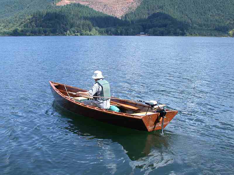

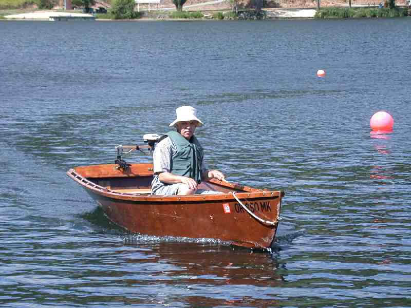

Well, the trolling motor remote setup in my photos is of the Mark I model.
Next time I do it, it'll probably look neater! ;o) The Glen-L trolling
motor remote control _is_ a neater layout than mine though (a friend of
mine did something similar using drag links), but it's thoroughly built
into the boat. The advantage of my layout is that it's completely
portable, so it can be removed when the boat is used for other purposes,
or swapped between boats. Glen-L and I came up with solutions to different
problems.

>http://www.boat-links.com/images/TrollingRemote/TrollingRemote-1.jpg
>http://www.boat-links.com/images/TrollingRemote/TrollingRemote-2.jpg
>http://www.boat-links.com/images/TrollingRemote/TrollingRemote-3.jpg

I did make a bracket to mount a trolling motor on my Junebug. I used 2 x 4
lumber, and 2 3-inch C-clamps. I bought a 30 lb. thrust Minn Kota Endura 30
locally for $100. I've posted a few photos on my web site, which I think
are self-explanatory.
The motor and set-up work beautifully. Today my wife and I quietly motored
up a small creek and snuck up on a pair of nesting swans and a bunch of
sunbathing turtles. I'll try to post some photos of the motor in action
later.
For the photos, go tohttp://mgalvin.com/boatbuilding/Junebug
<http://mgalvin.com/boatbuilding/Junebug%20Motor%20Bracket> Motor Bracket
Mike Galvin
Muskegon, Michigan
mgalvin.com/boatbuilding has items of interest to Bolgerphiles

That expensive 50 lb. Minn Kota would be overkill on a June Bug. Minn
Kota's Endura 30 has plenty of power for a boat like June Bug, and they're
often on sale for less than $100. You won't feel so bad butchering a $100-
motor to rig it up for remote control. <g>
