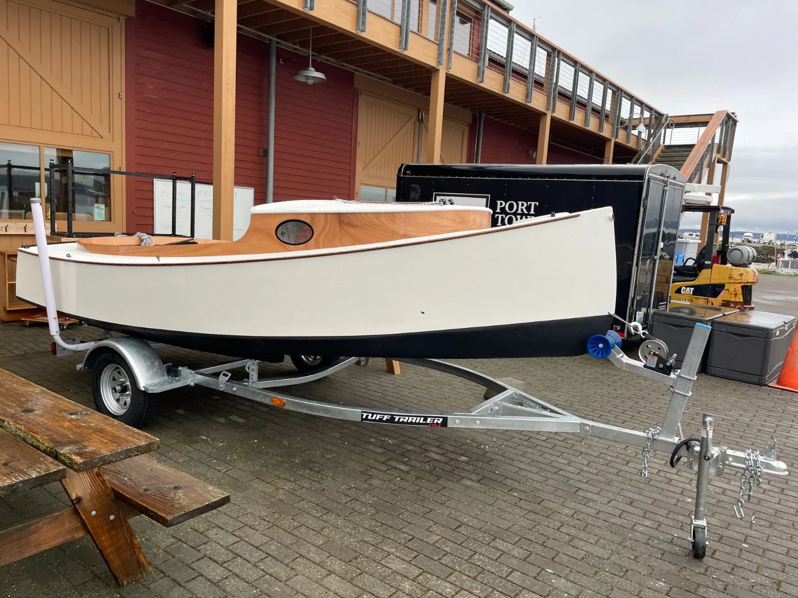

The Northwest Maritime Center in Port Townsend WA hosted a two week class building the Old Salt prototype. Five boats are being built at once. Shop time of 2 weeks and 4 weeks extra was offered. I chose the 2 week extra time for a total of 1 month. Class started March 1 2026. Class is led by Joel Arrington boat shop manager of the Northwest Maritime Center. Joel is an accomplished and knowledgeable craftsman and has lead classes building dozens of designs. The first prototype was built over the winter and is in the first picture.

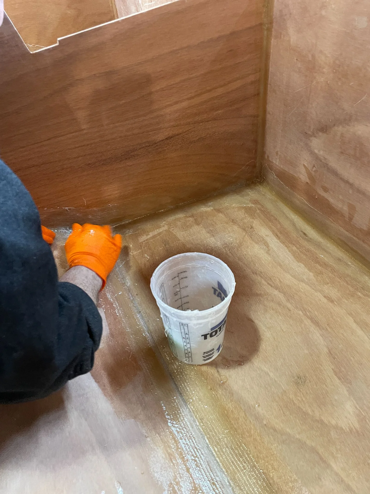

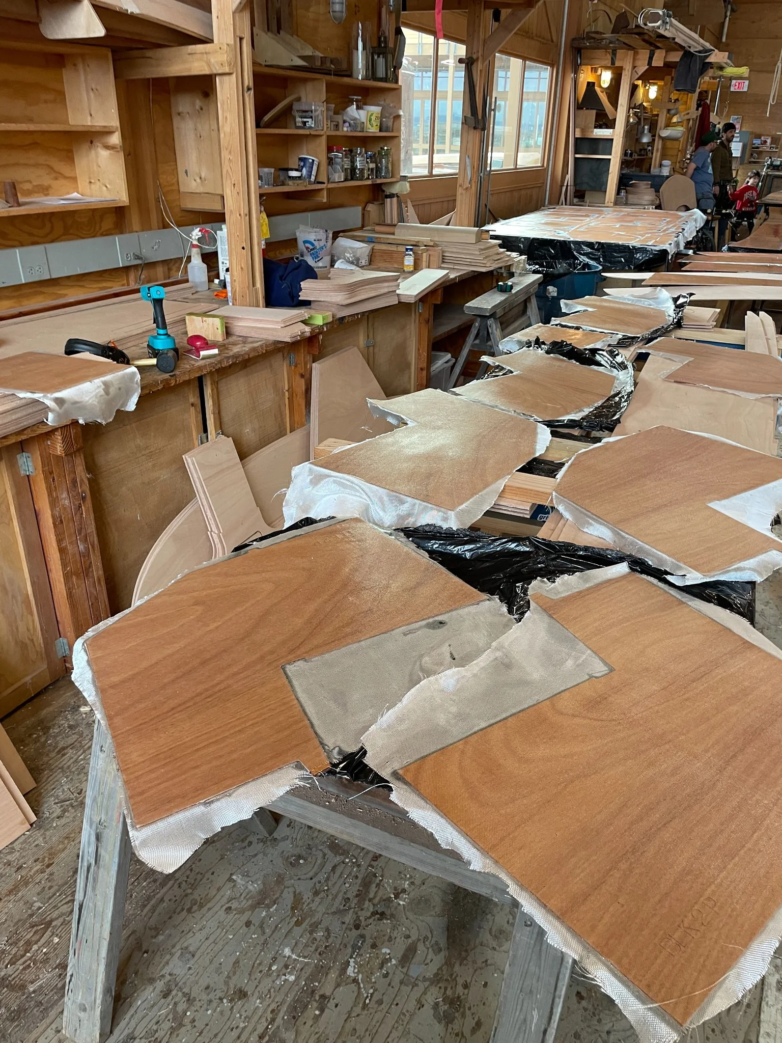

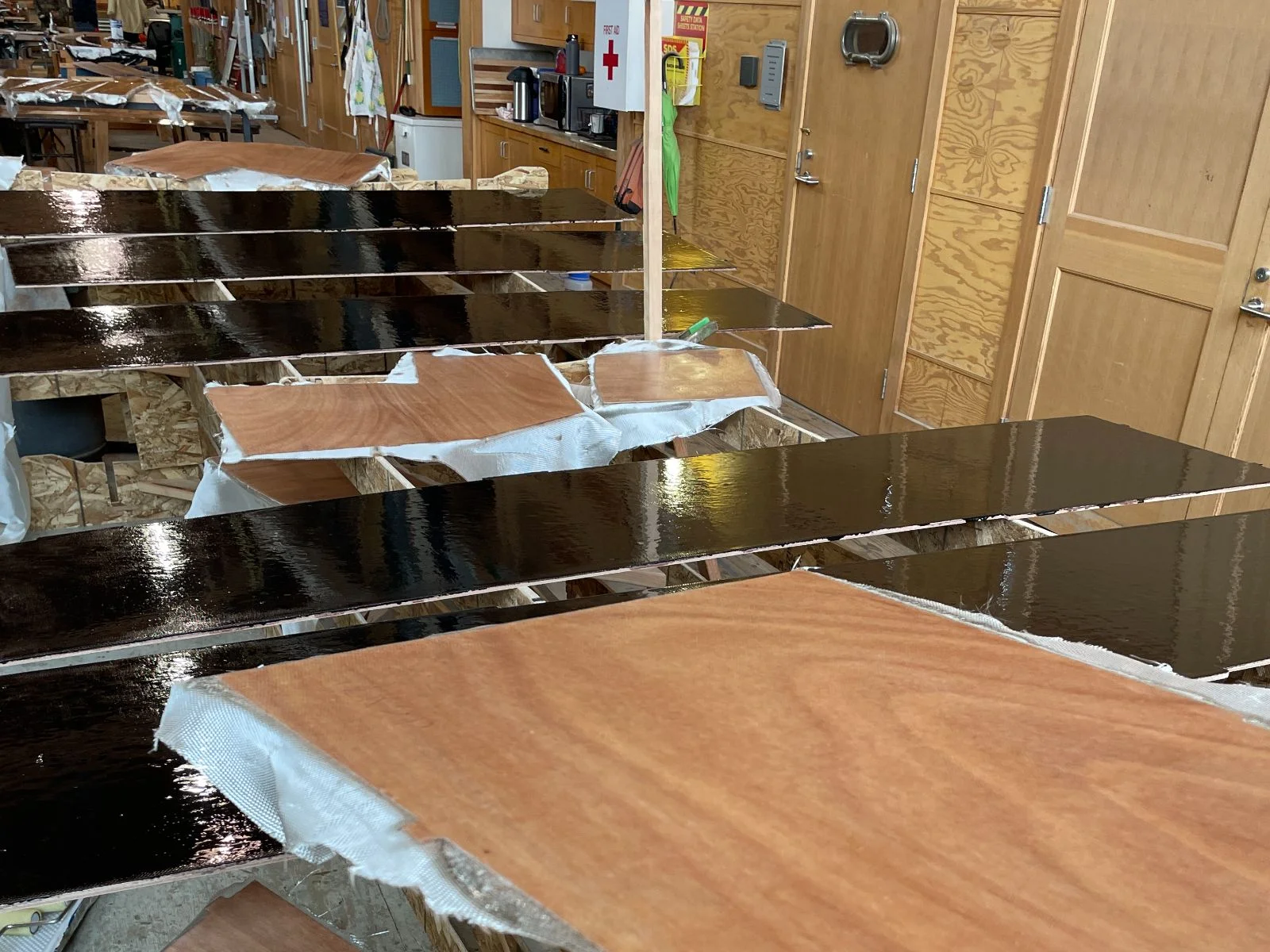

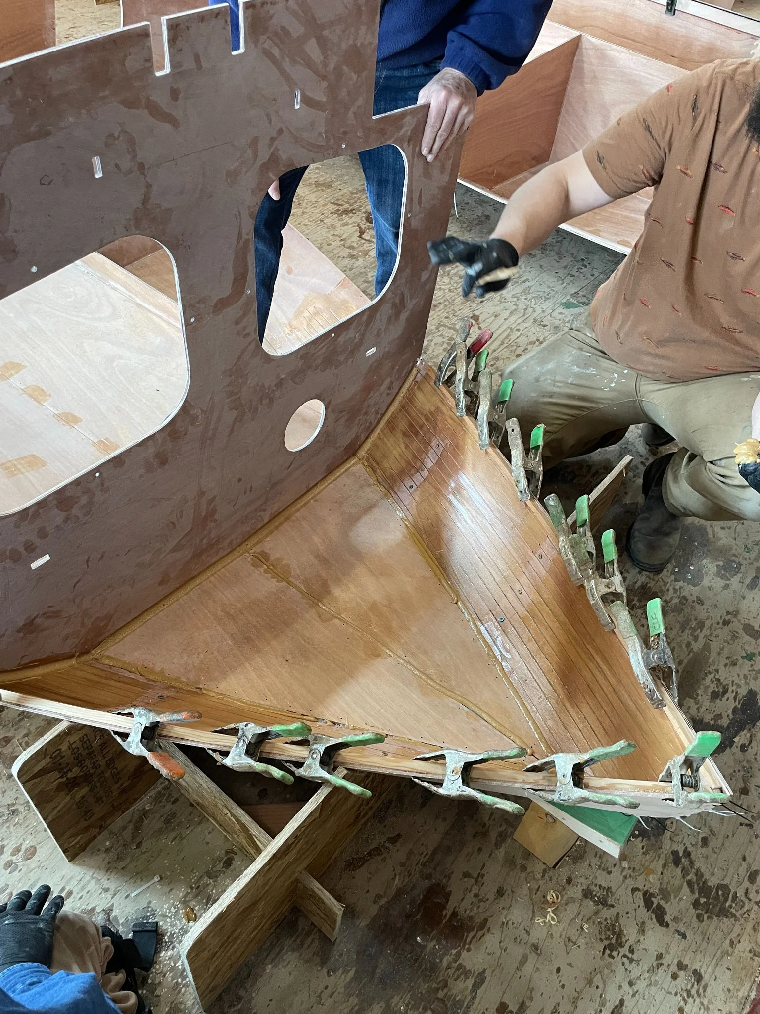

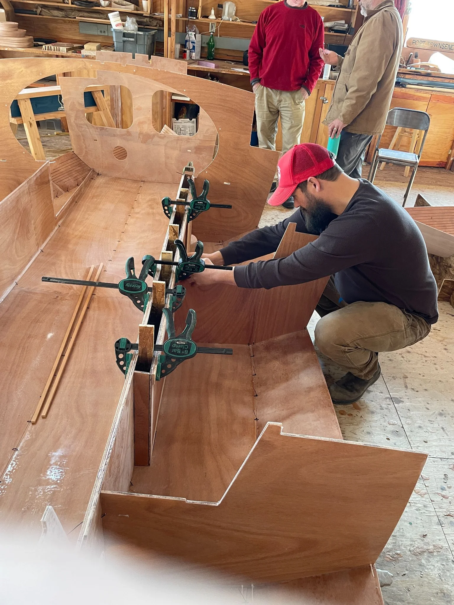

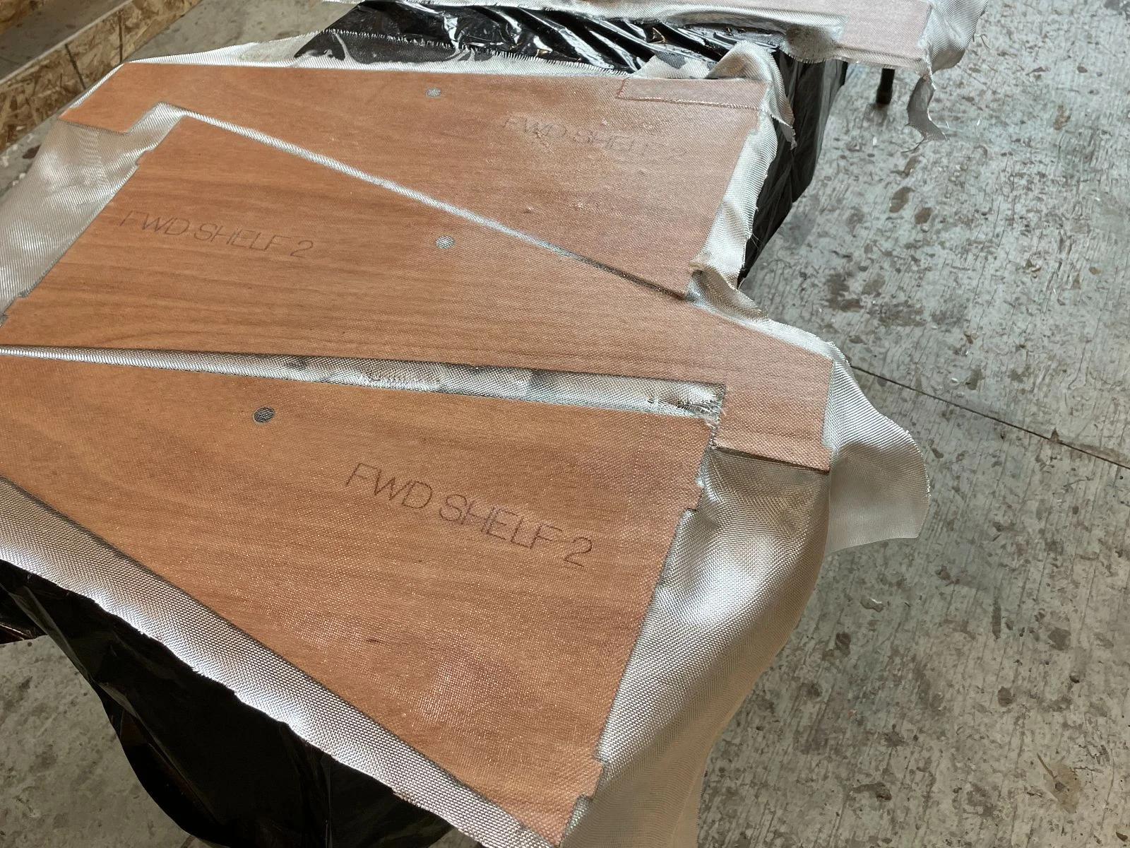

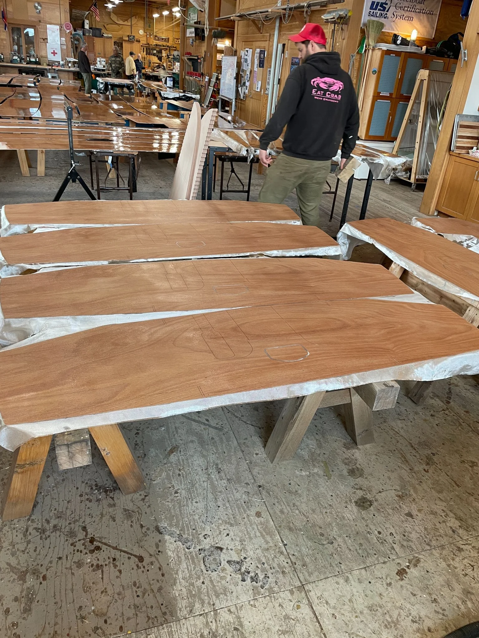

Week 1 was spent laminating CNC cut parts, trimming, squaring alignment pegs and slots.

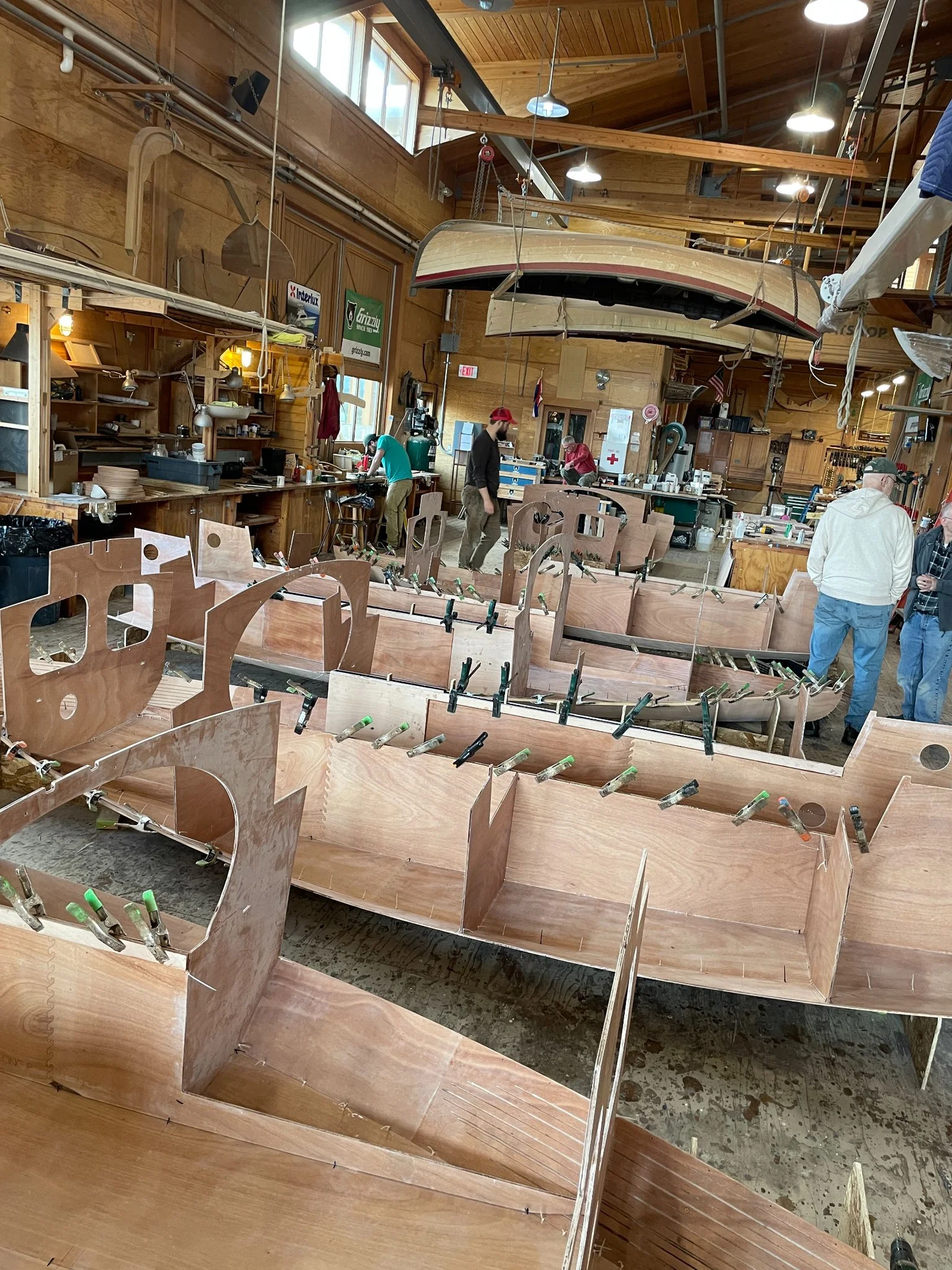

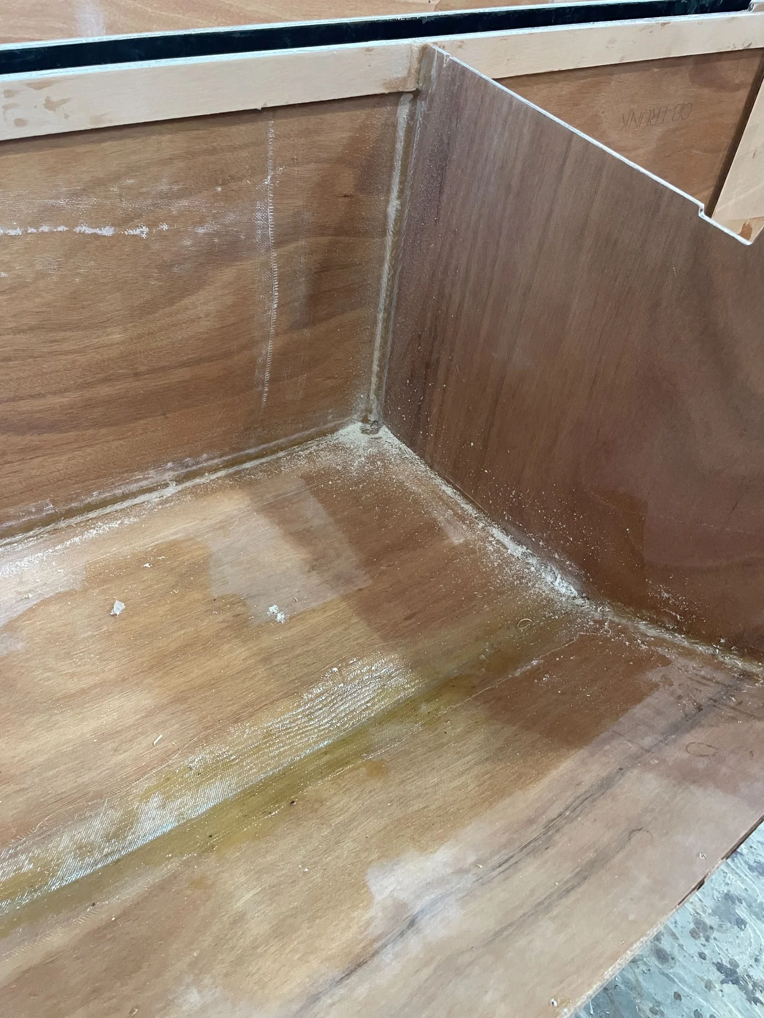

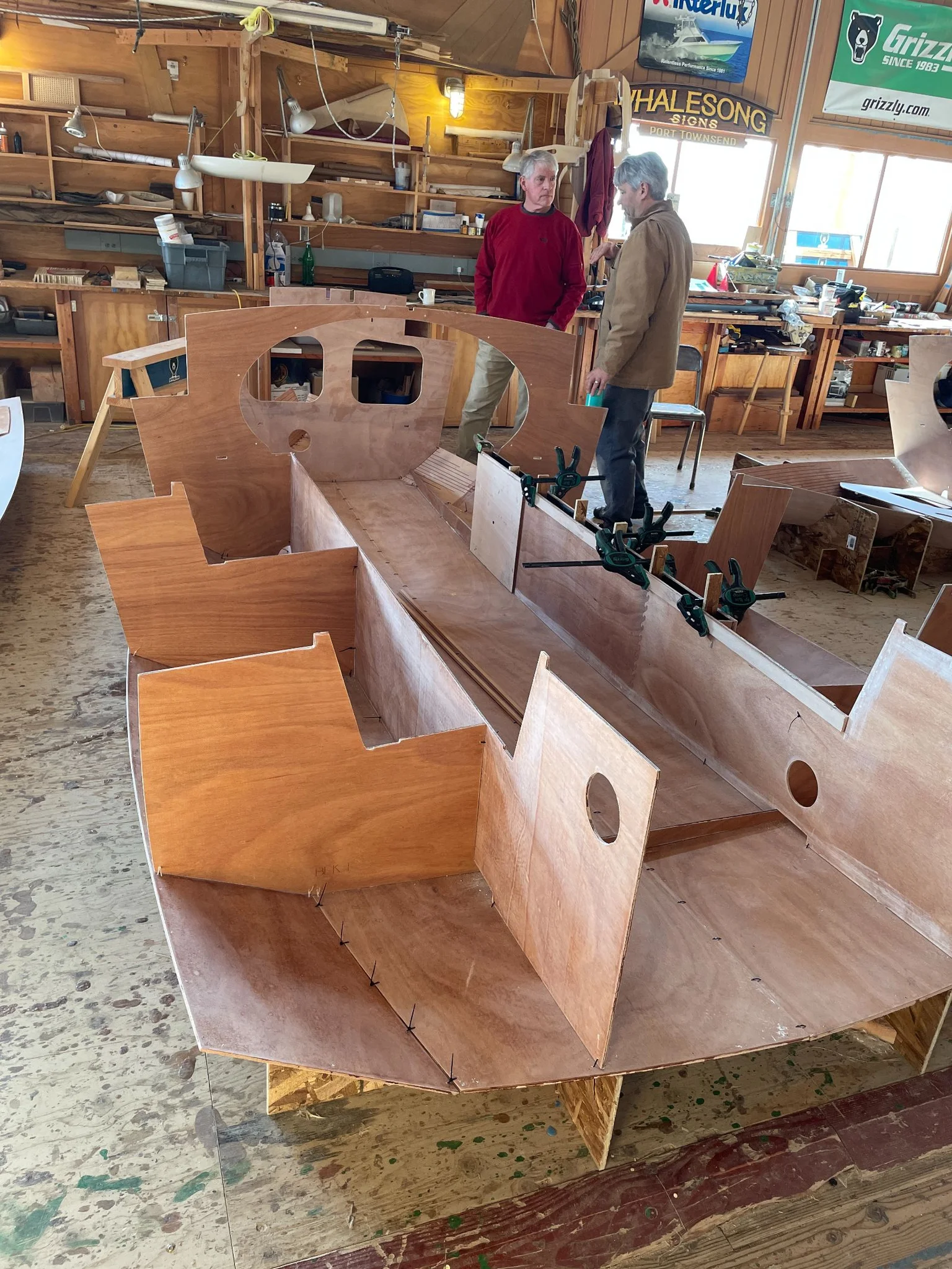

Week 2 we zip tied the two hull pieces and added the garboard plank and the transverse bulkheads. The centerboard trunk was added to the starboard side of the hull (it is located in the starboard bench seat. All are supported by a prefab form to control shape. Everything was then filleted and glassed into place.
Progress End of Week 2
March 16
Notice the kerfs in the garboard planks at the bow that enable the correct shape to be obtained.
