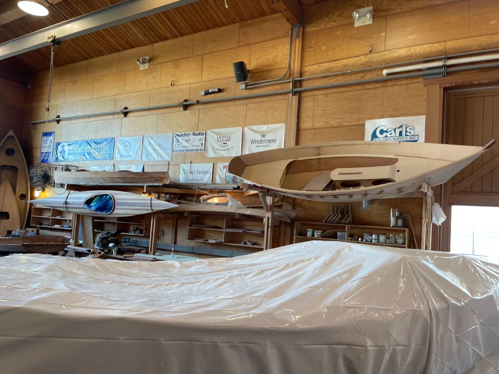

The Northwest Maritime Center in Port Townsend WA hosted a two week class building the Old Salt prototype. Five boats are being built at once. Shop time of 2 weeks and 4 weeks extra was offered. I chose the 2 week extra time for a total of 1 month. Class started March 1 2026. Class is led by Joel Arrington boat shop manager of the Northwest Maritime Center. Joel is an accomplished and knowledgeable craftsman and has lead classes building dozens of designs. The first prototype was built over the winter and is in the first picture.

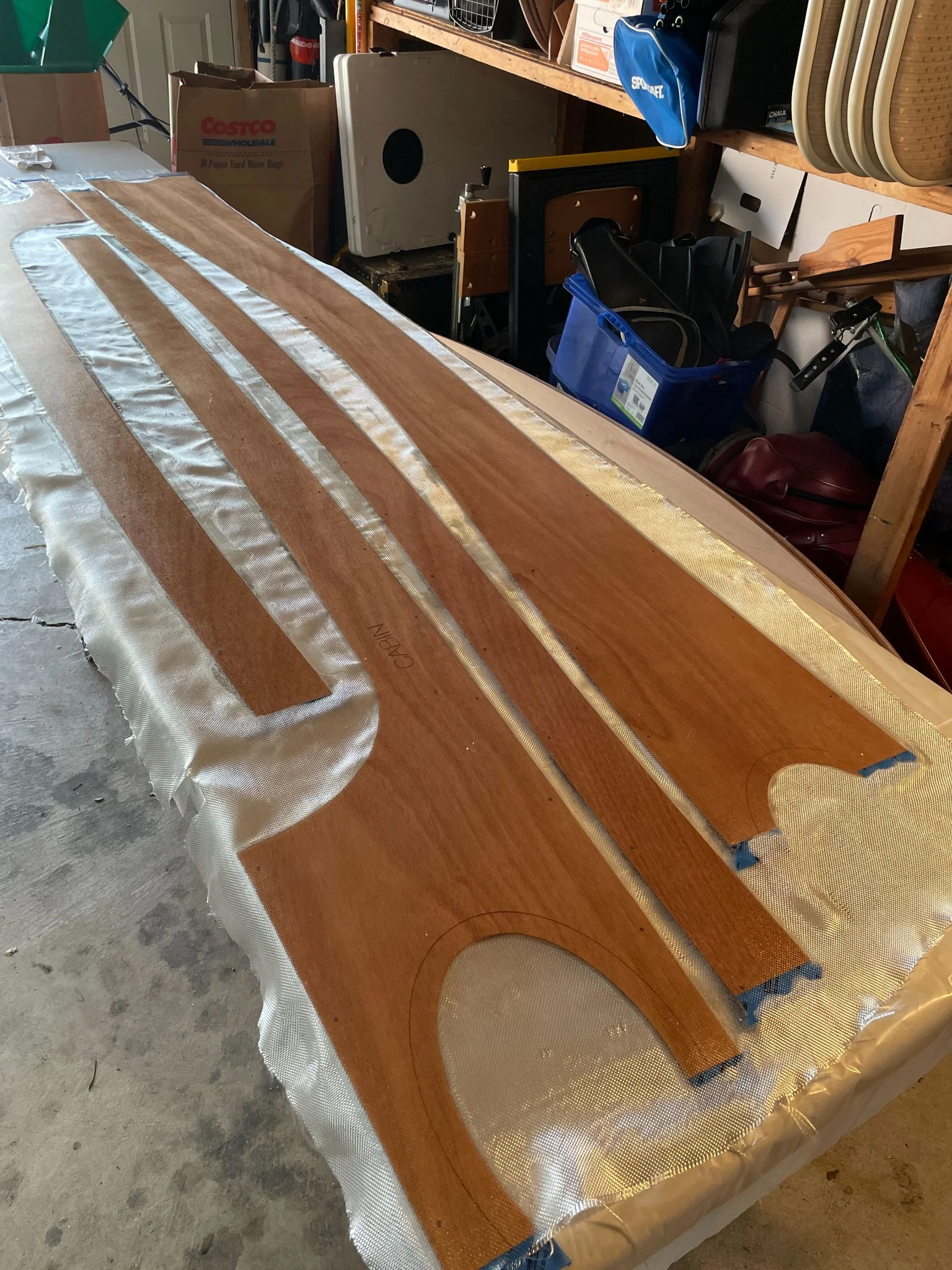

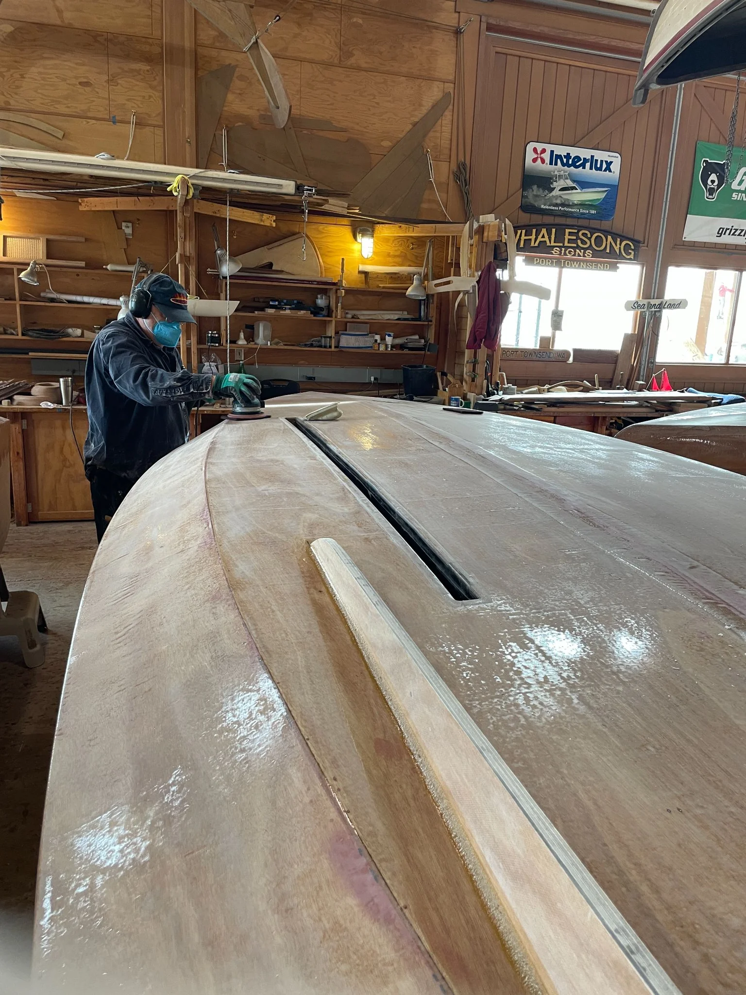

Week 1 was spent laminating CNC cut parts, trimming, squaring alignment pegs and slots.

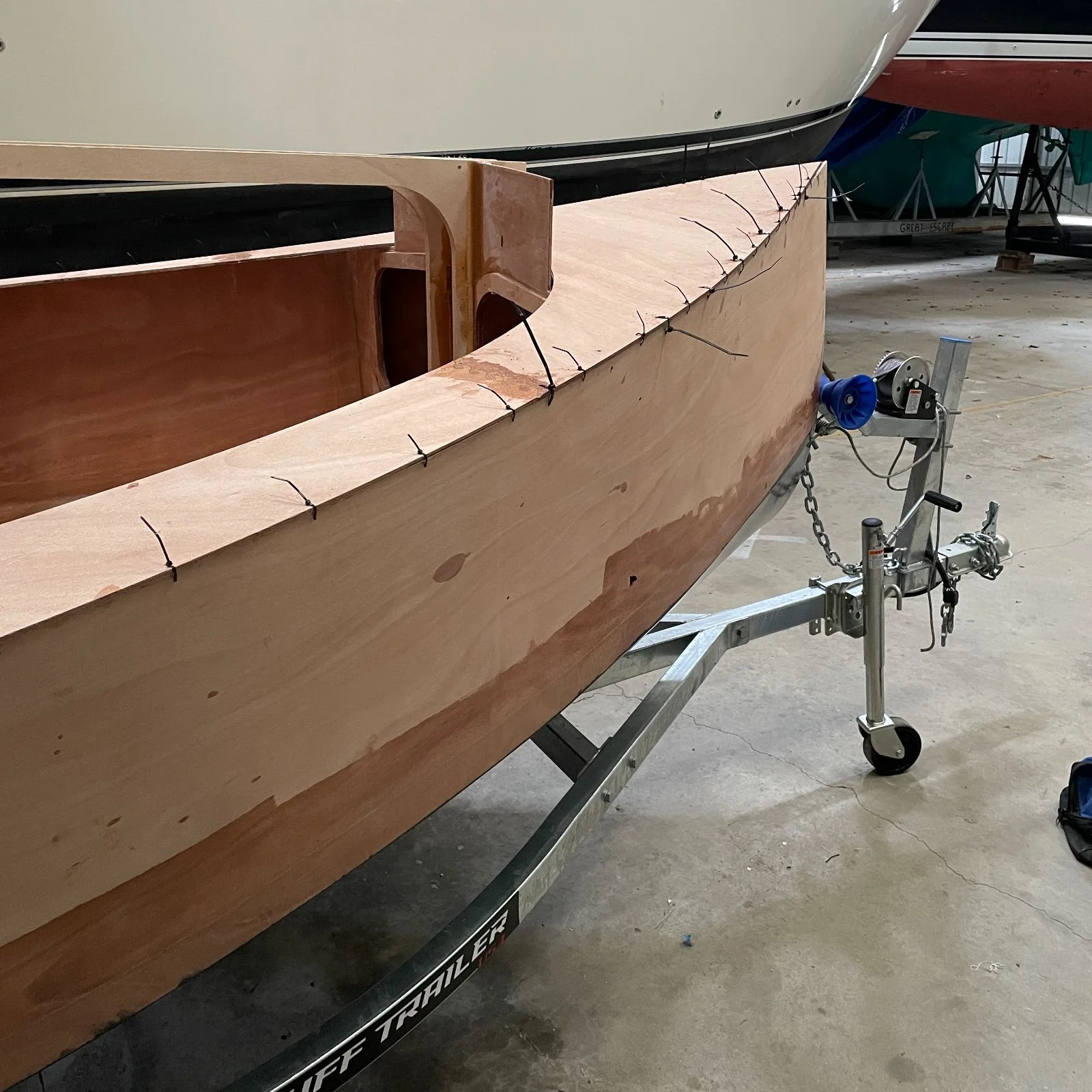

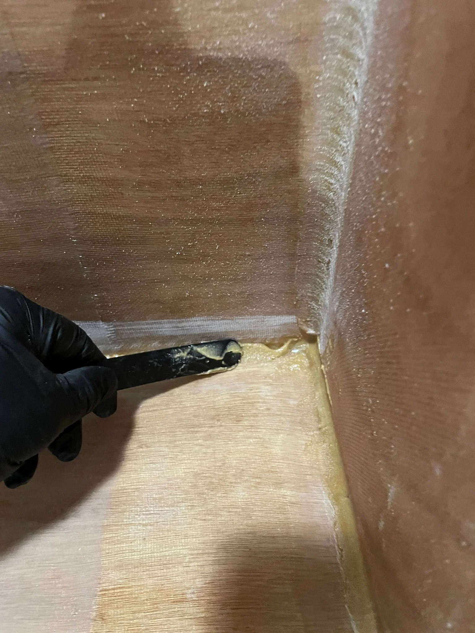

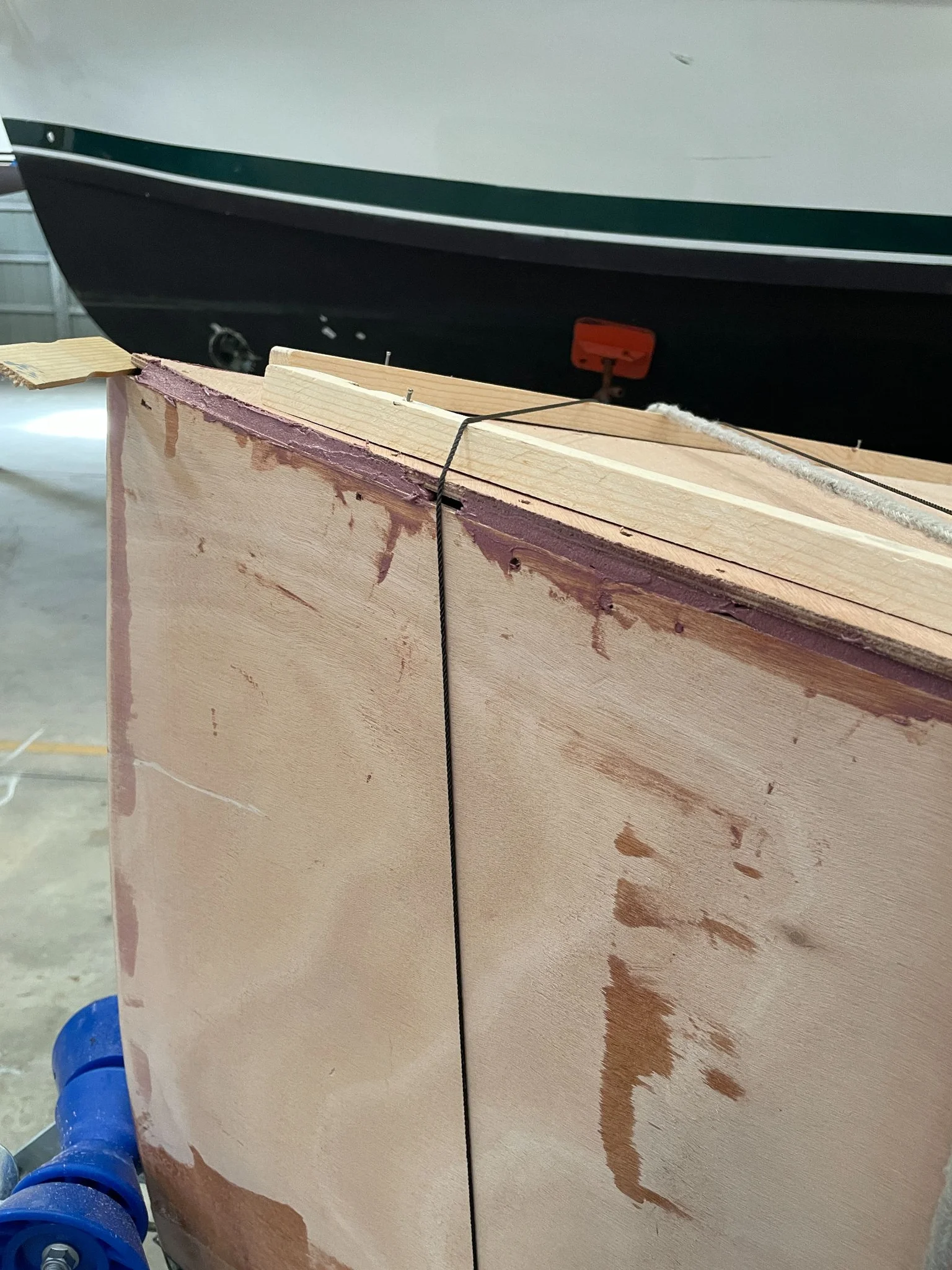

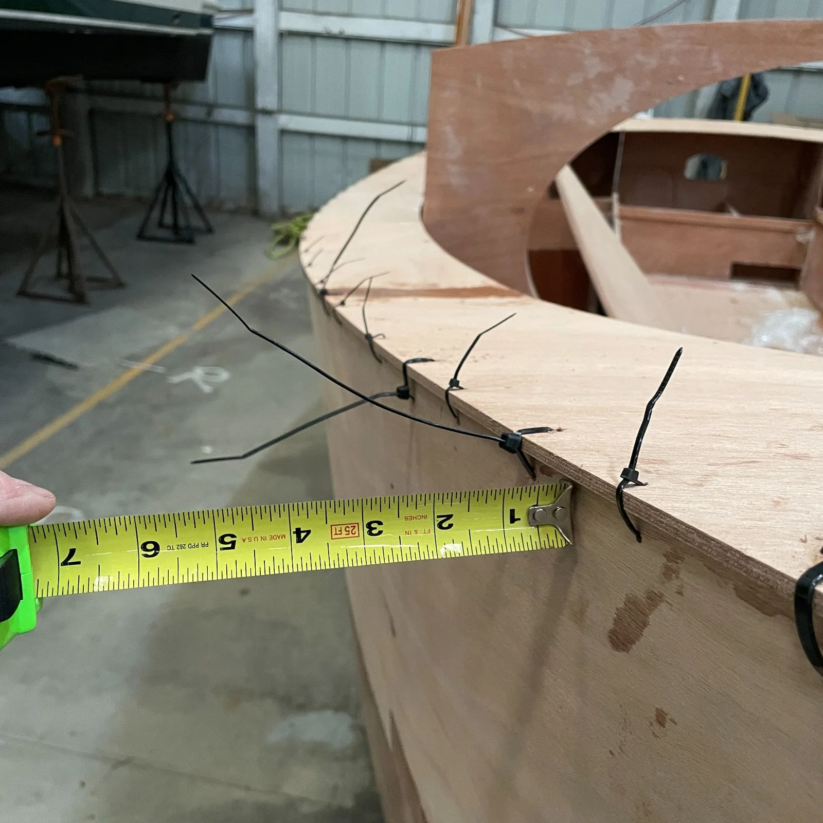

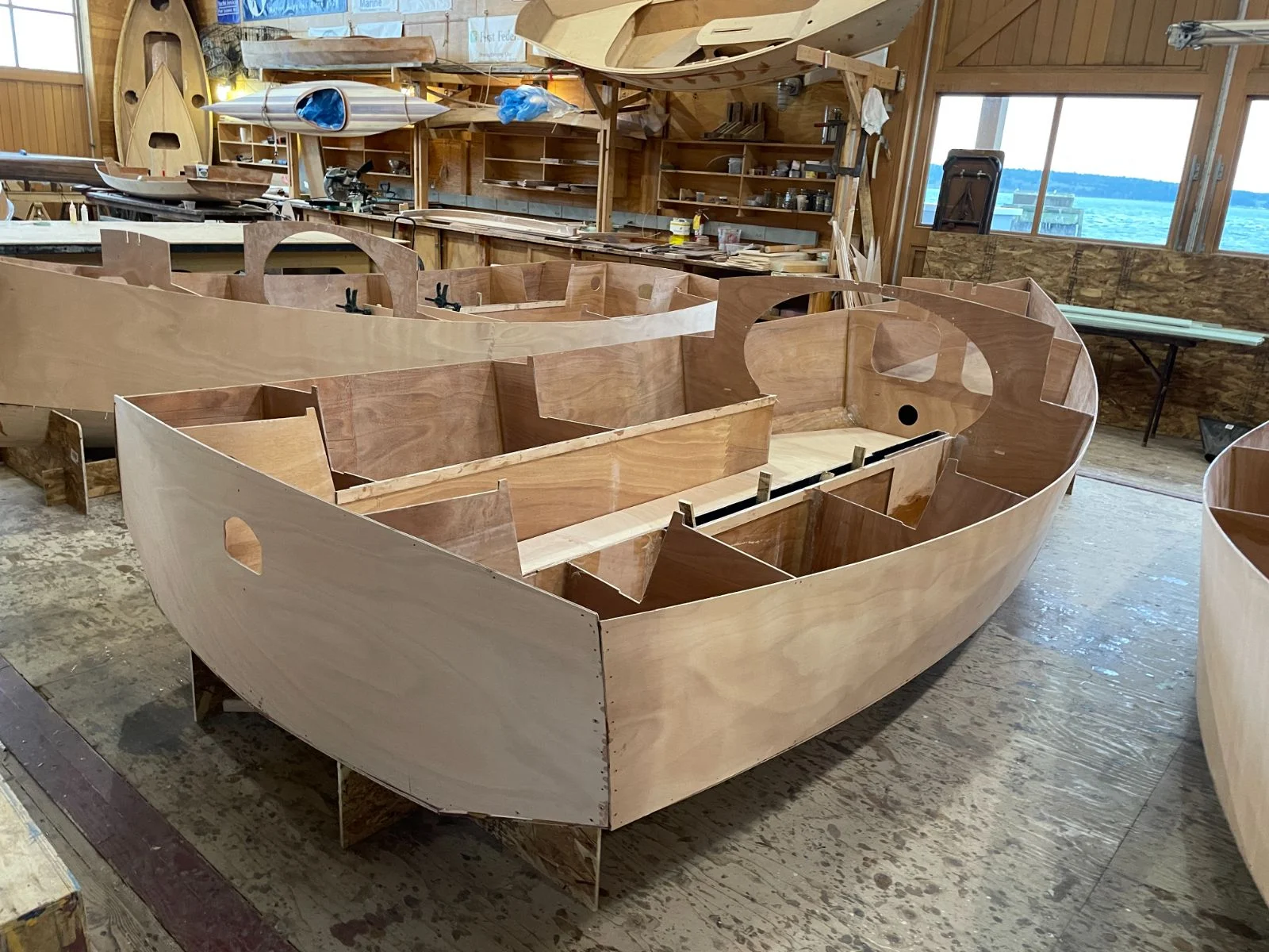

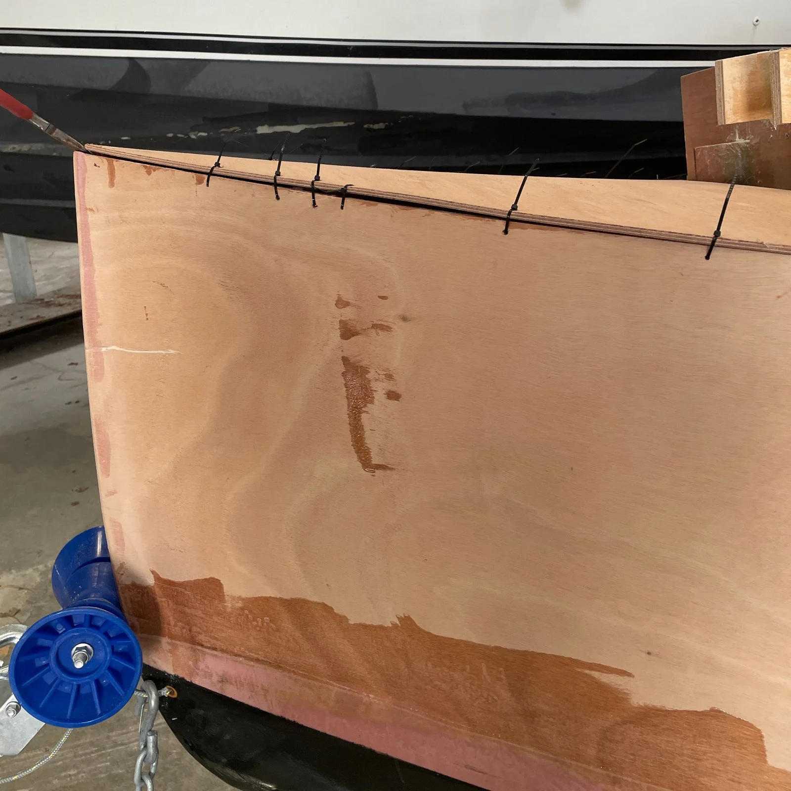

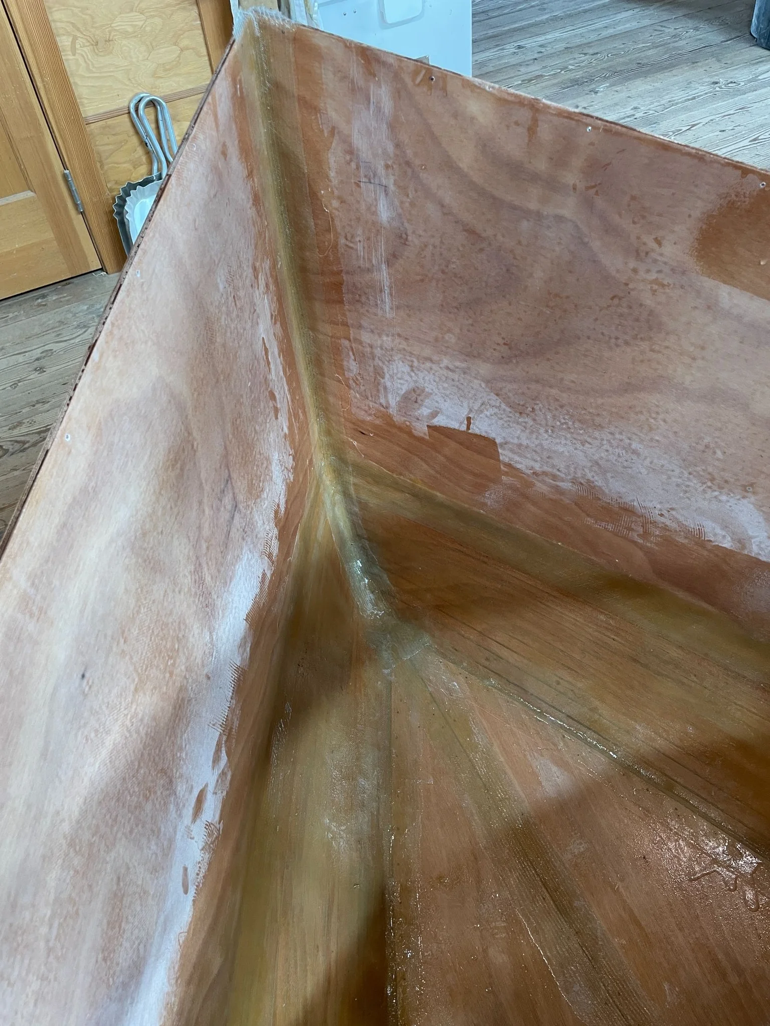

Week 2 we zip tied the two hull pieces and added the garboard plank and the transverse bulkheads. The centerboard trunk was added to the starboard side of the hull (it is located in the starboard bench seat. All are supported by a prefab form to control shape. Everything was then filleted and glassed into place.
Progress End of Week 2
March 16
Notice the kerfs in the garboard planks at the bow that enable the correct shape to be obtained.

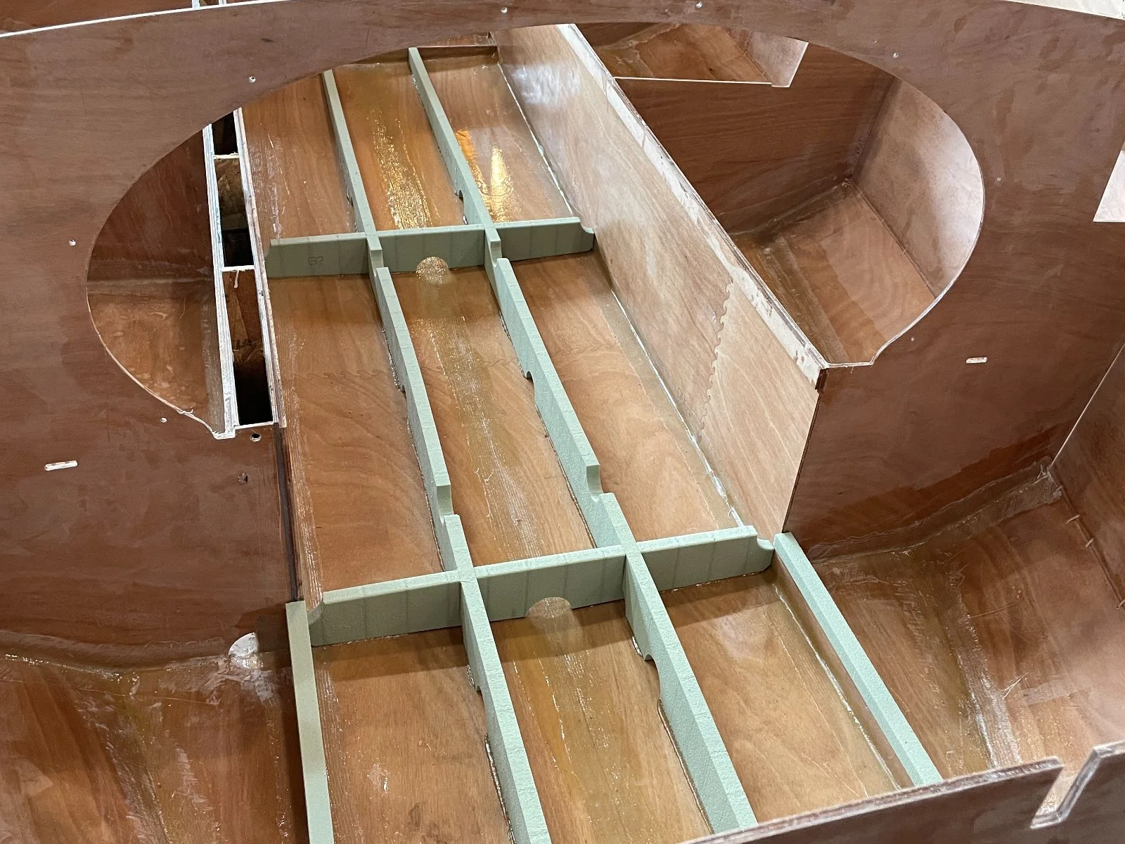

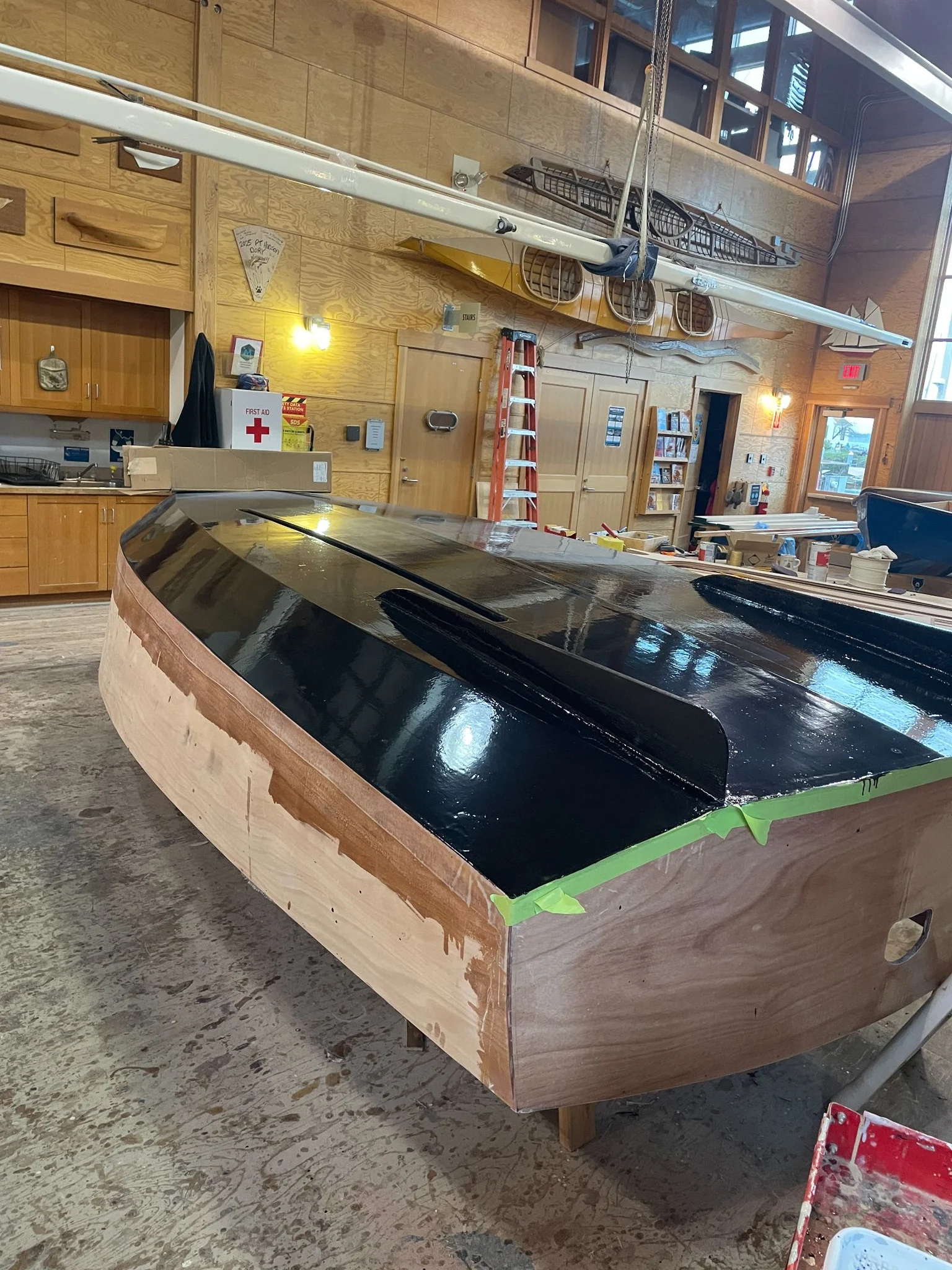

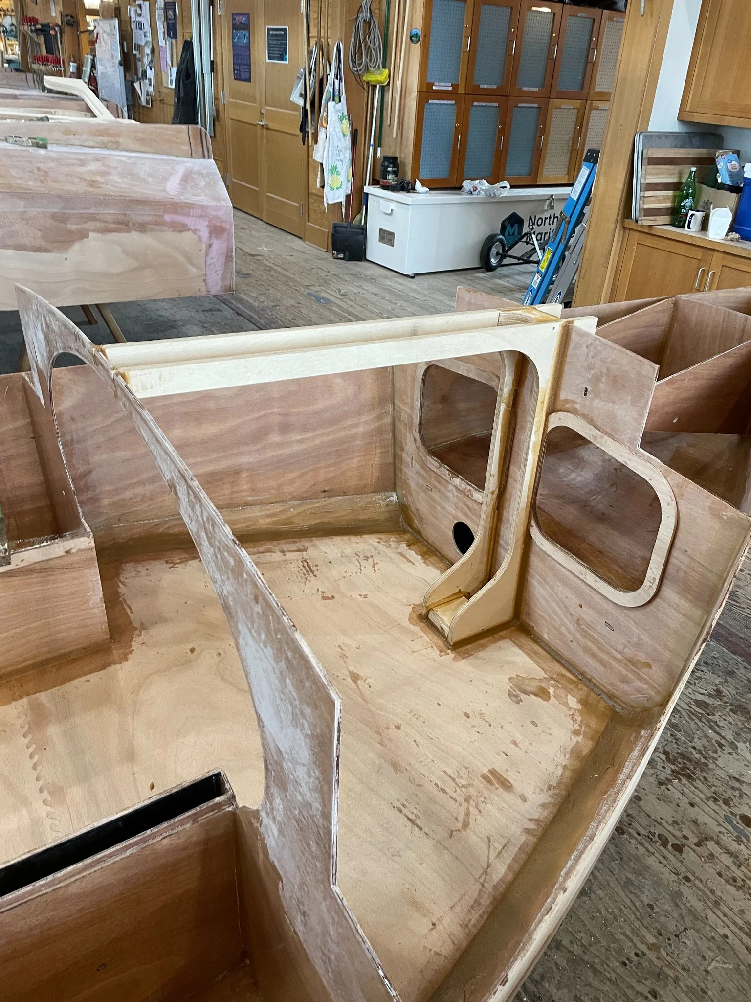

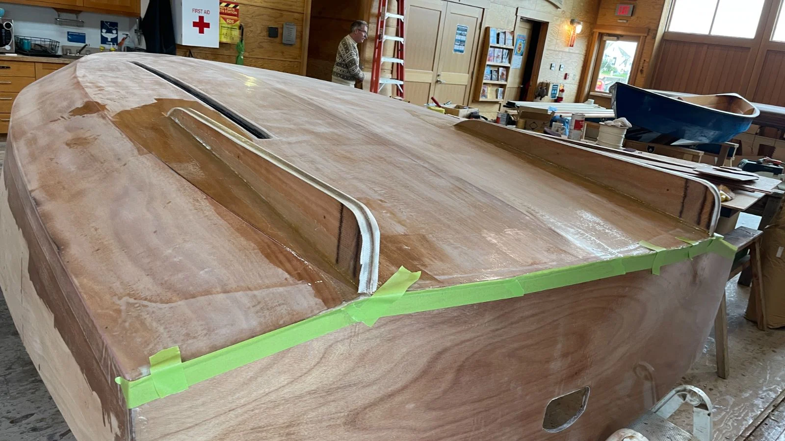

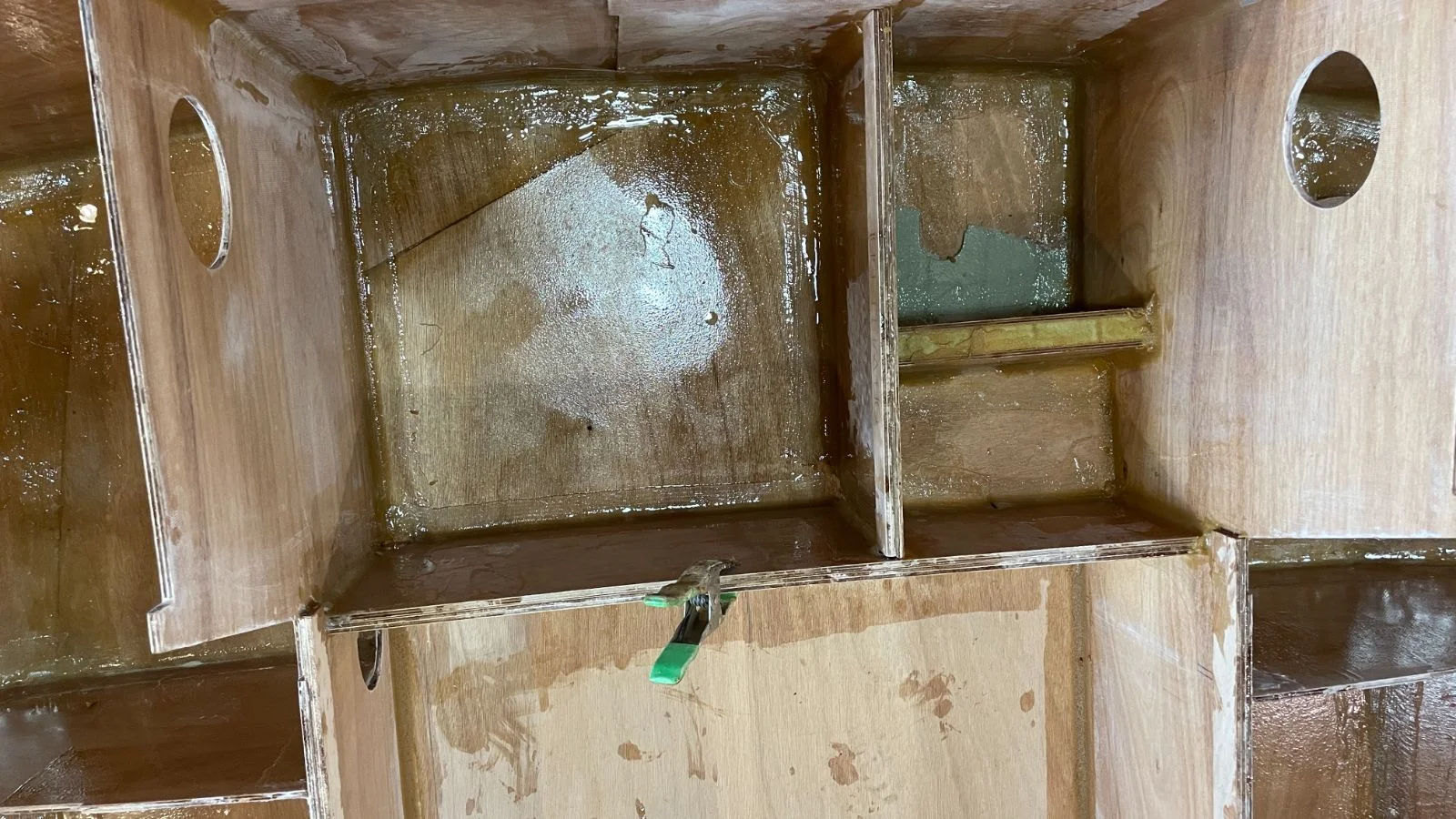

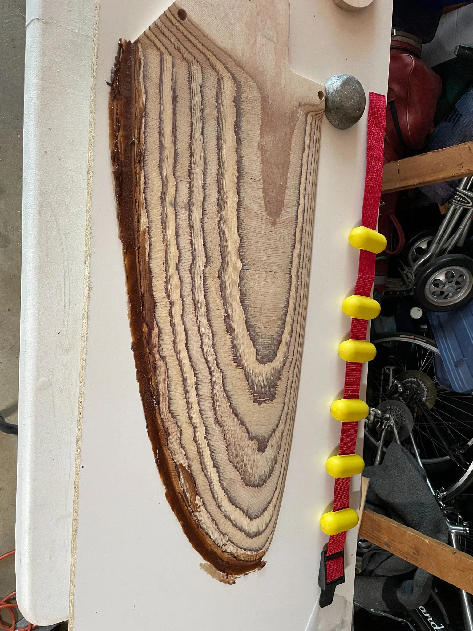

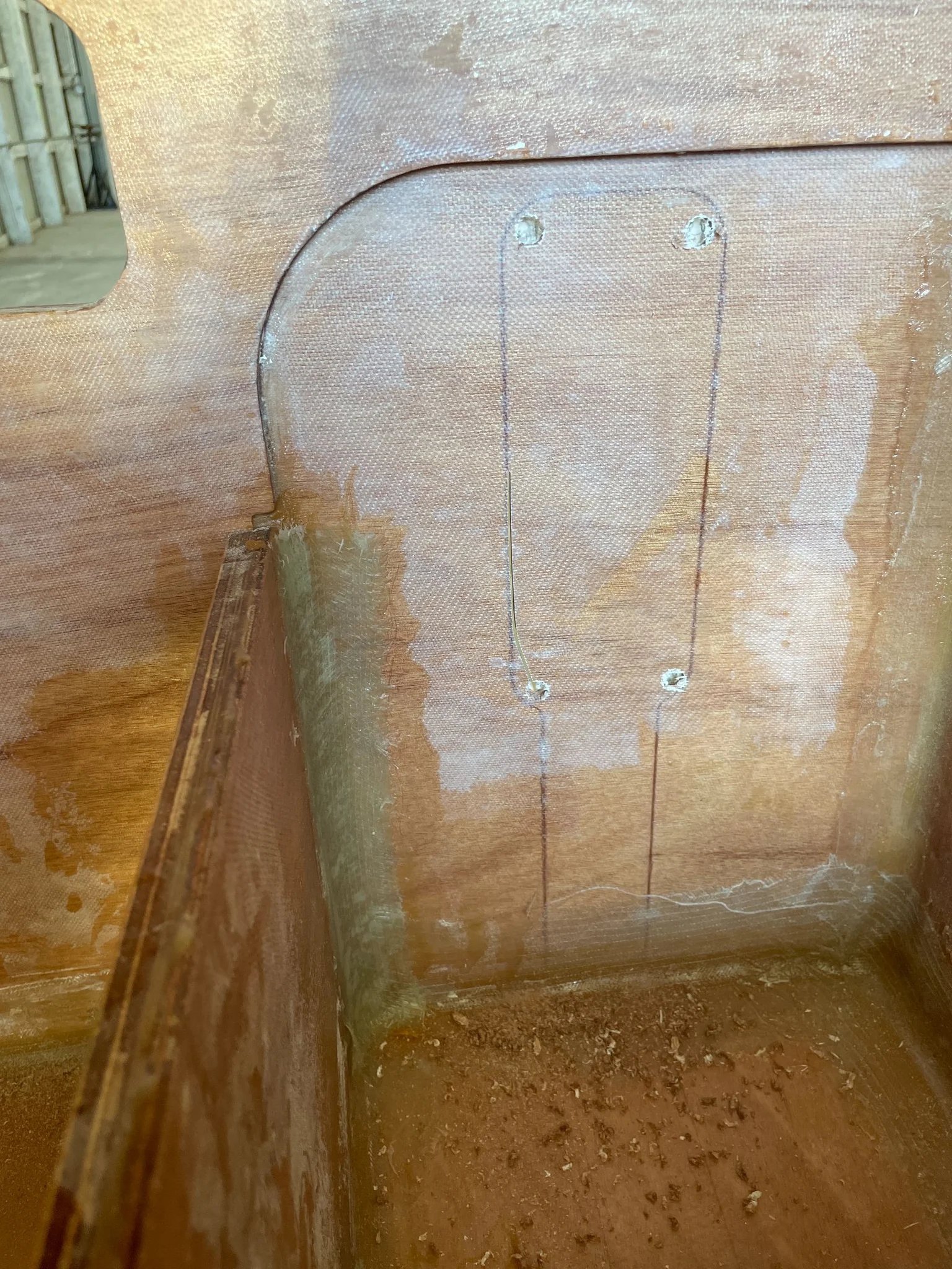

Getting bulkheads, mast step, centerboard slot, and motor well detailed
April 12
This was where we ended up a day before my departure.

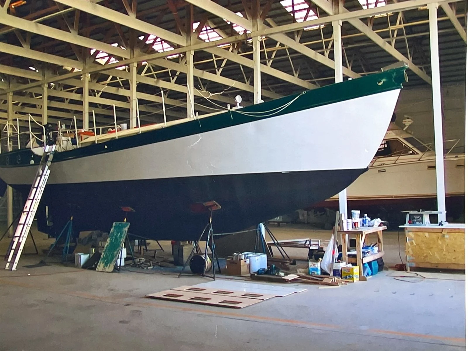

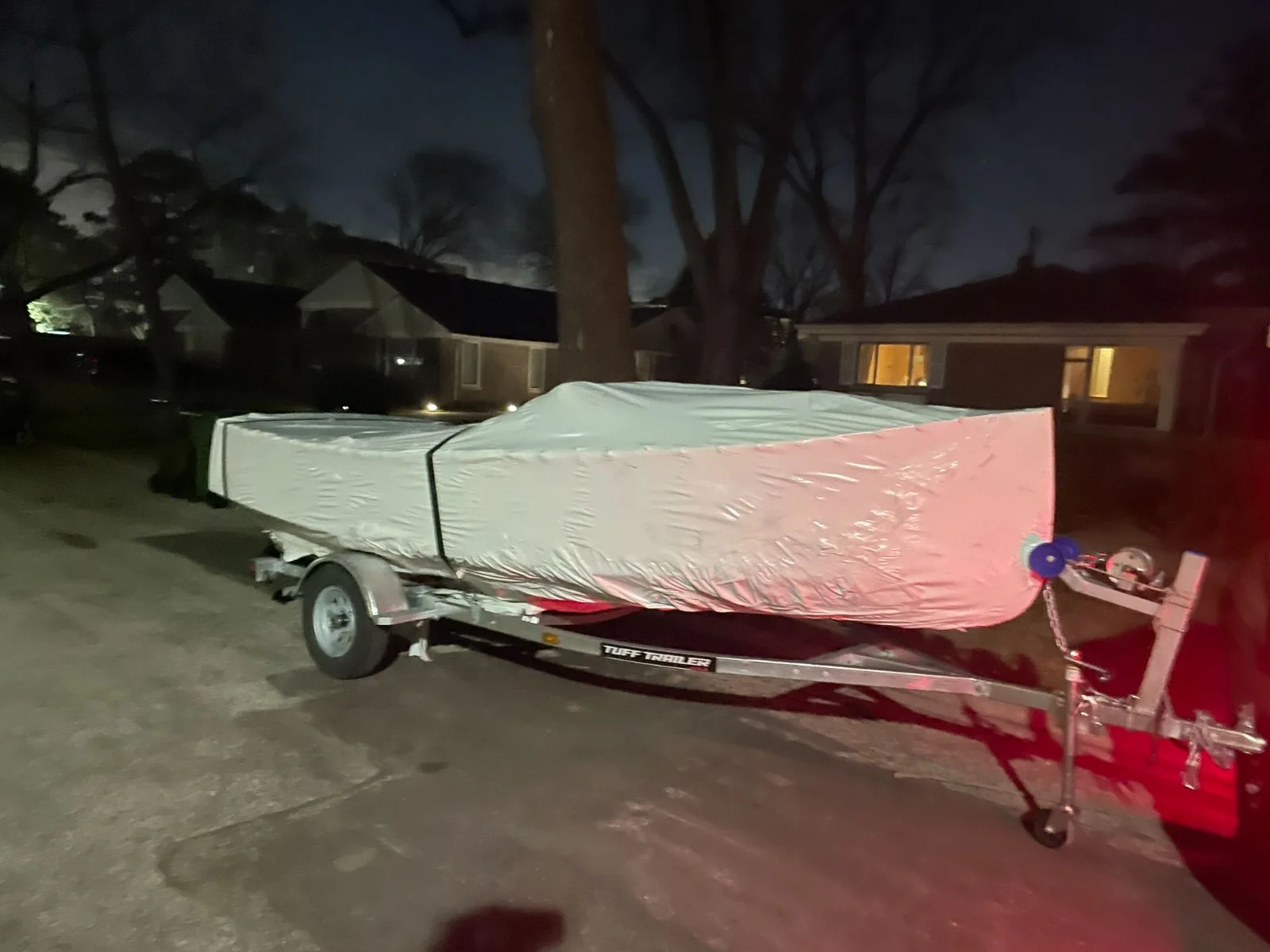

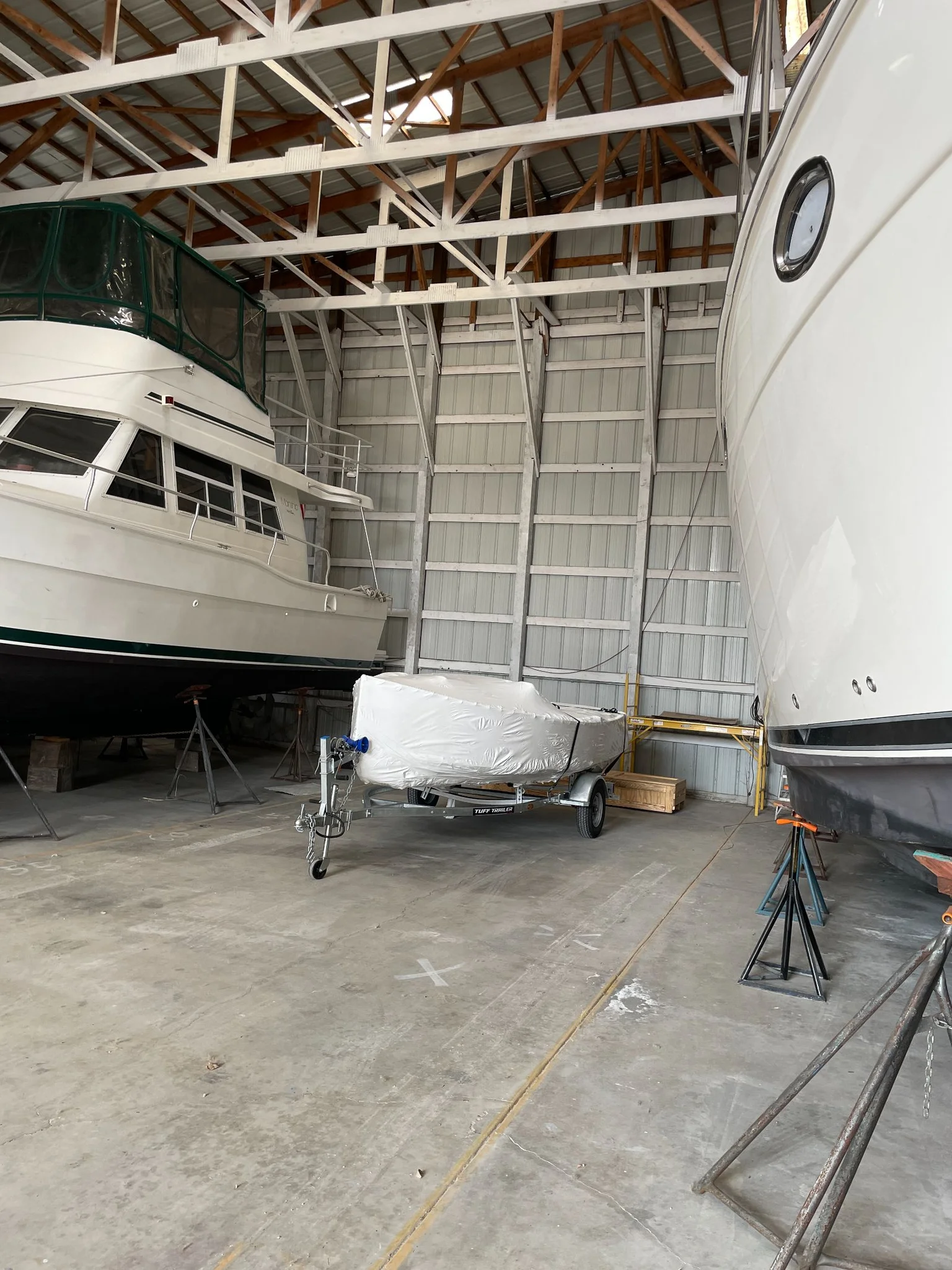

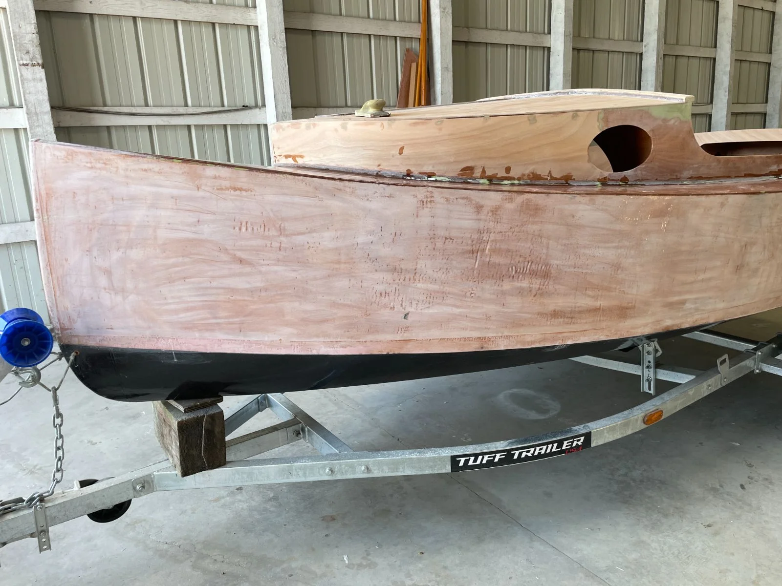

I used uShip as a broker - guy towed with a diesel powered BMW sedan. New trailer from Westside Marine in Port Townsend WA. Great guys - they delivered the trailer (I had no car), picked up a lock and tie downs, and gave me a discount on top of that! My Old Salt is now waiting for it to get warm in the same shed at Larsen Marine in Waukegan IL that I rebuilt my schooner 20 years ago.

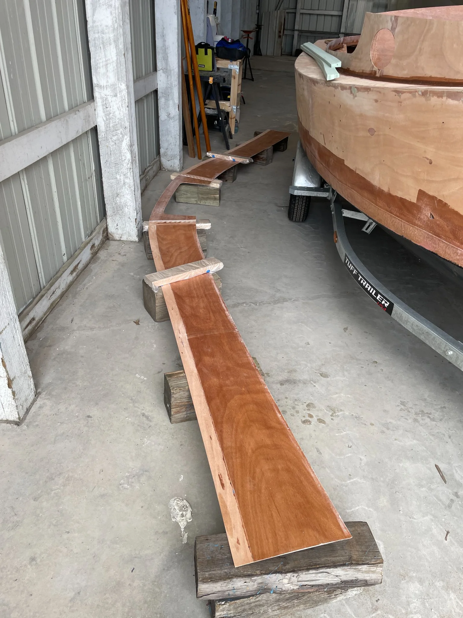

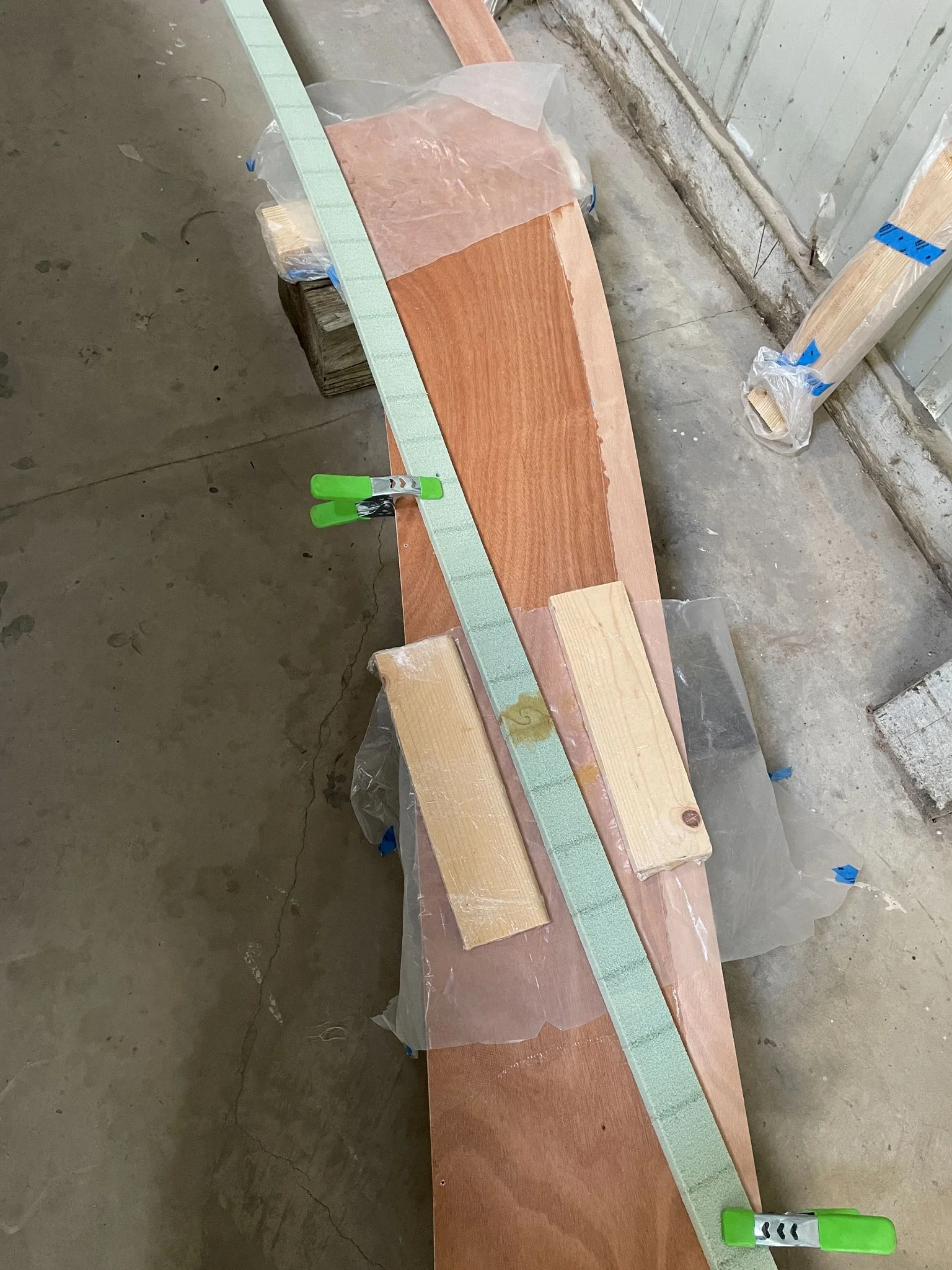

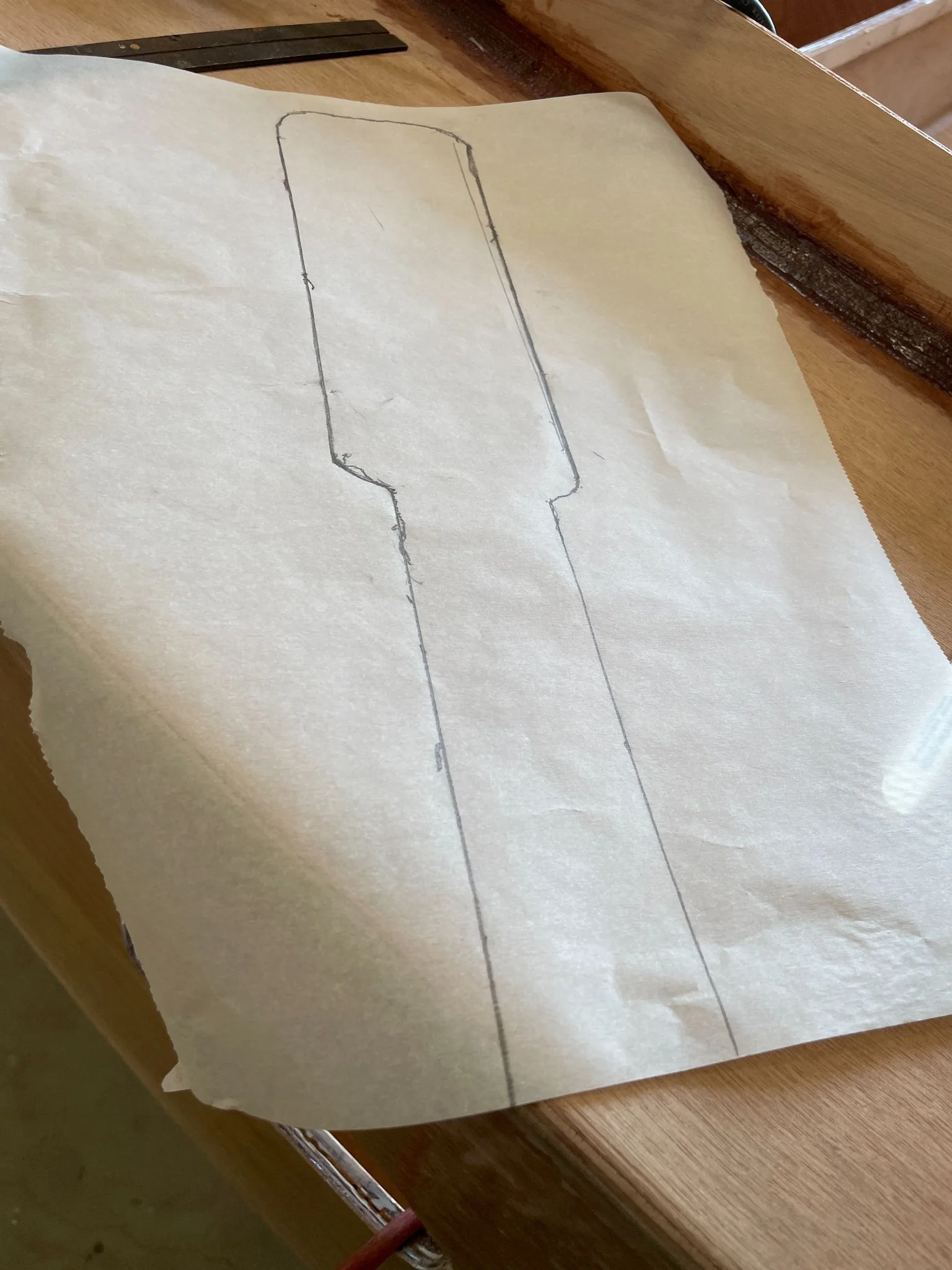

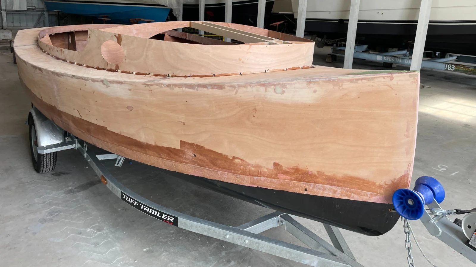

The boat has been home for 4 weeks, slow but steady progress

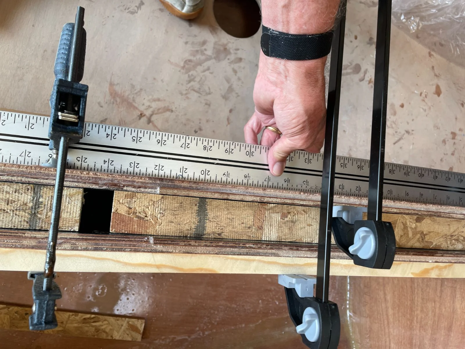

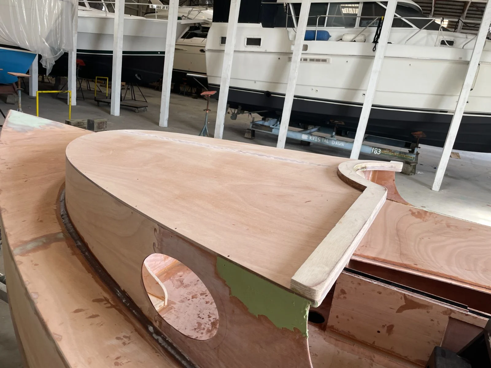

Fitting the Deck
April 25

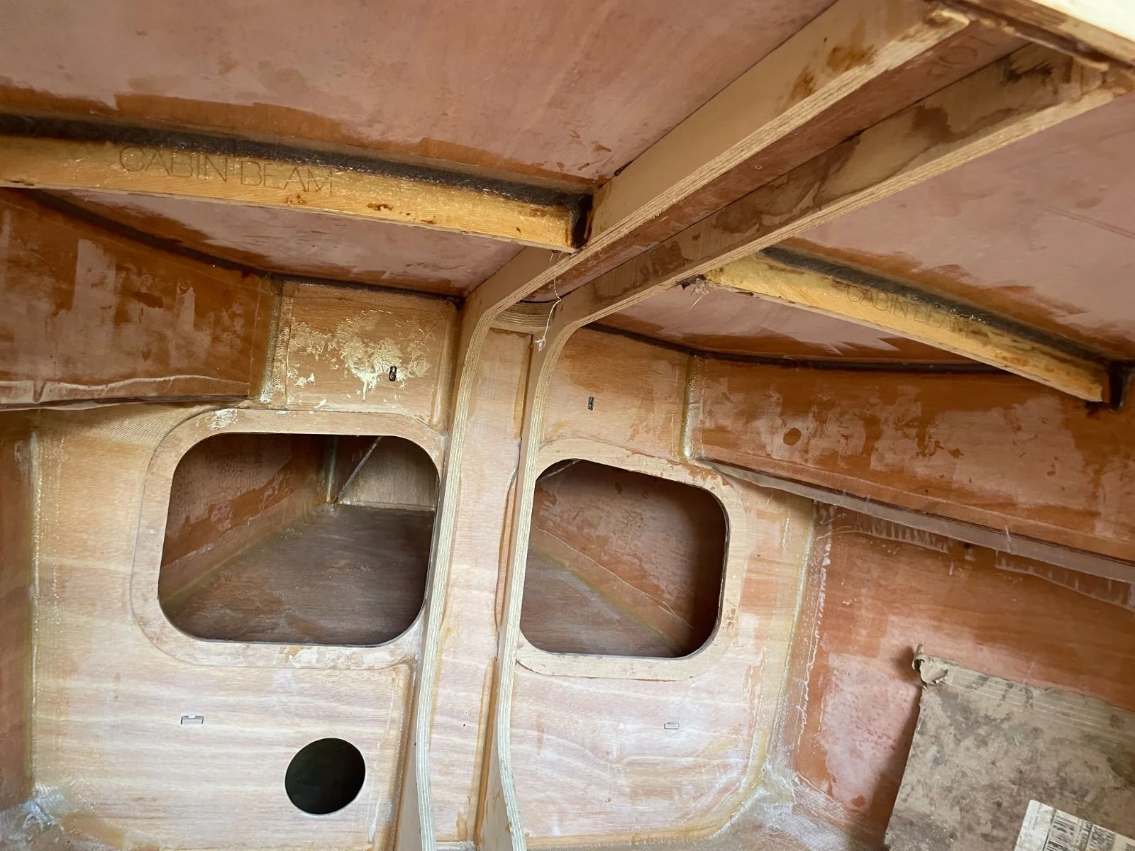

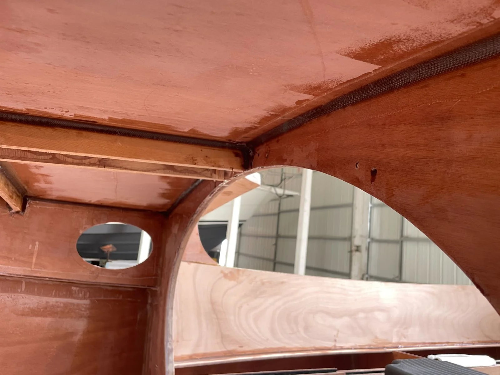

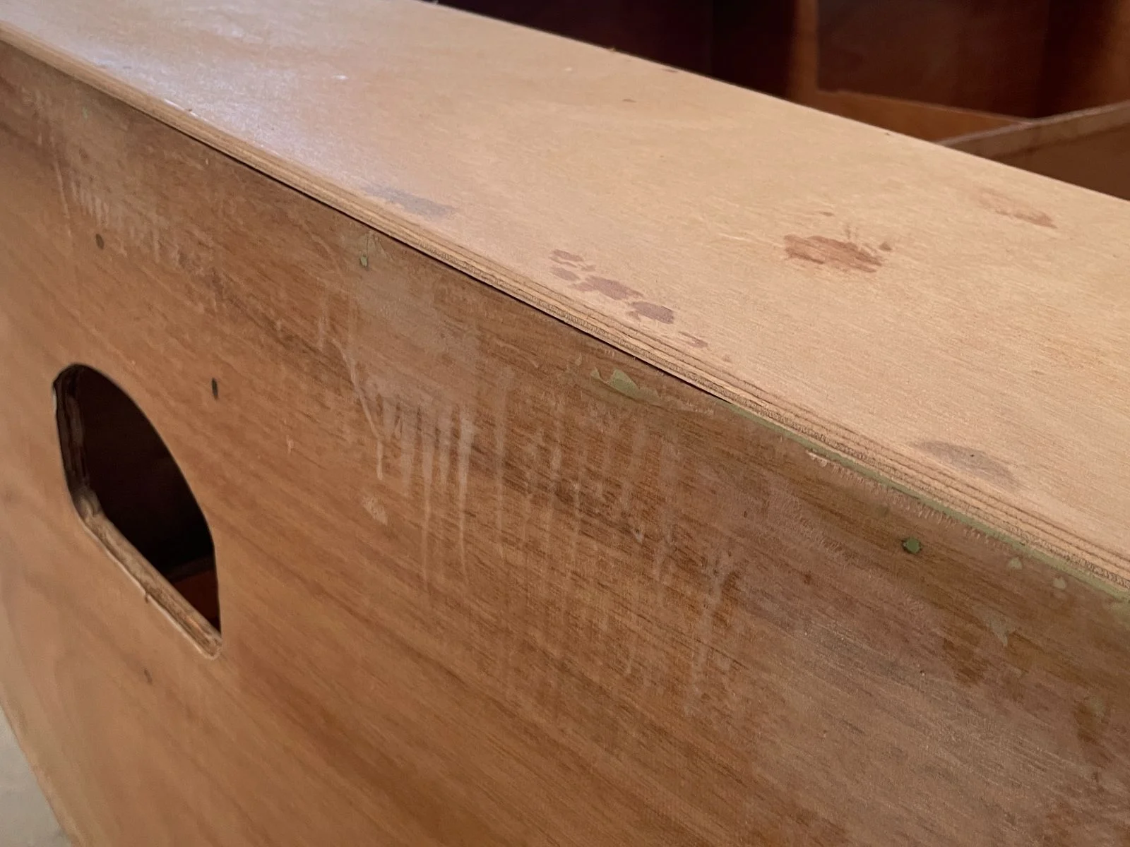

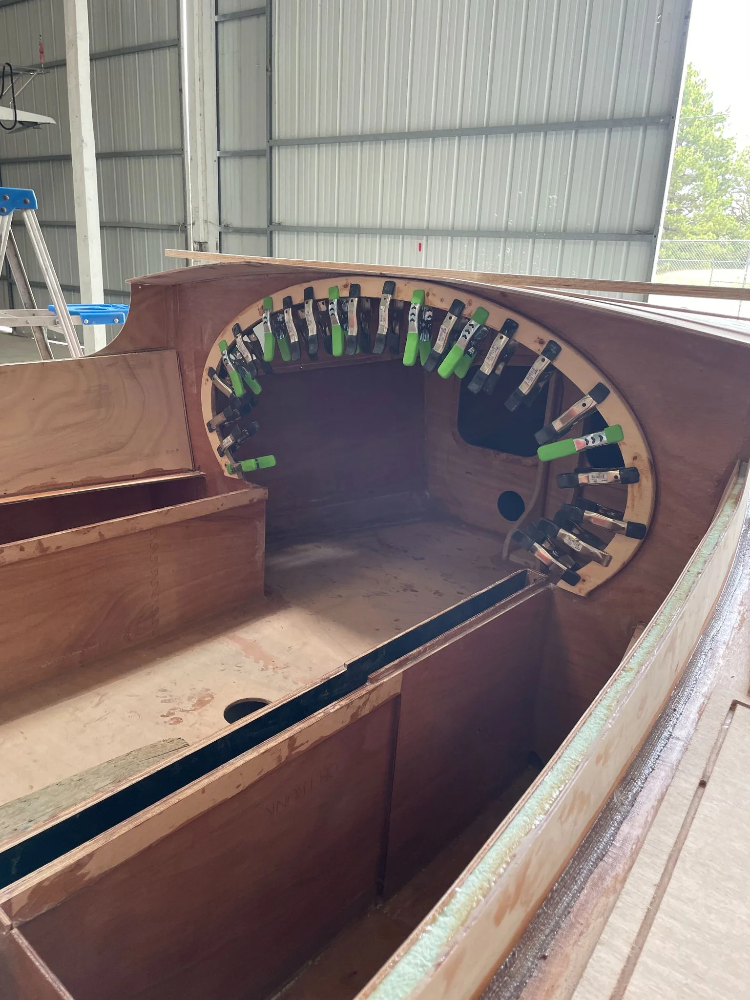

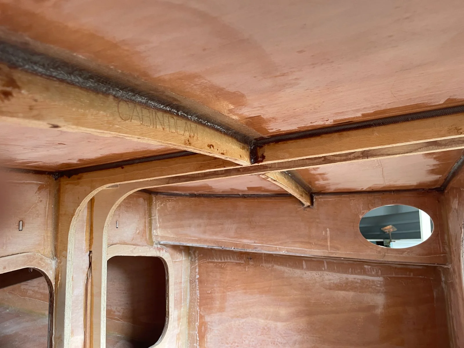

Cabin Sides Installed
July 26
Photo 1
Photo 2
Photo 3
Photo 4
