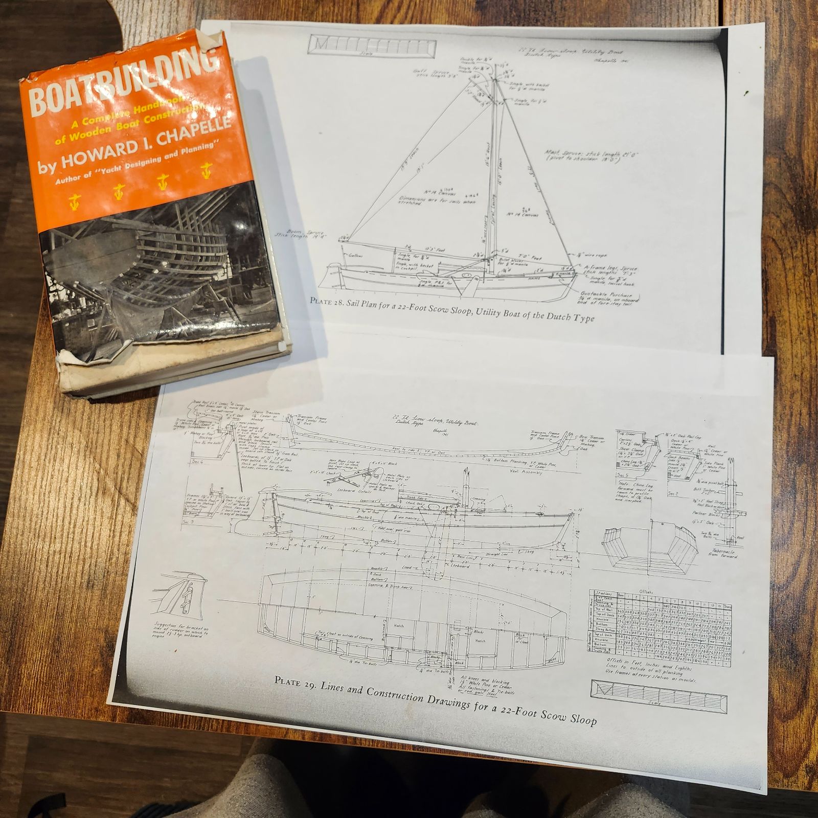

Howard Chapelles 22' Dutch Utility Scow. From "Boat building" by Howard Chapelle. Plate 28. & 29.
Modified for plywood construction.
I was taken by this boat after immersing my self into Howard Chapelles book, "boat building". I spent days looking, thinkng, dreaming. So, I decided to do something about it. I'm still not sure if it was a good idea

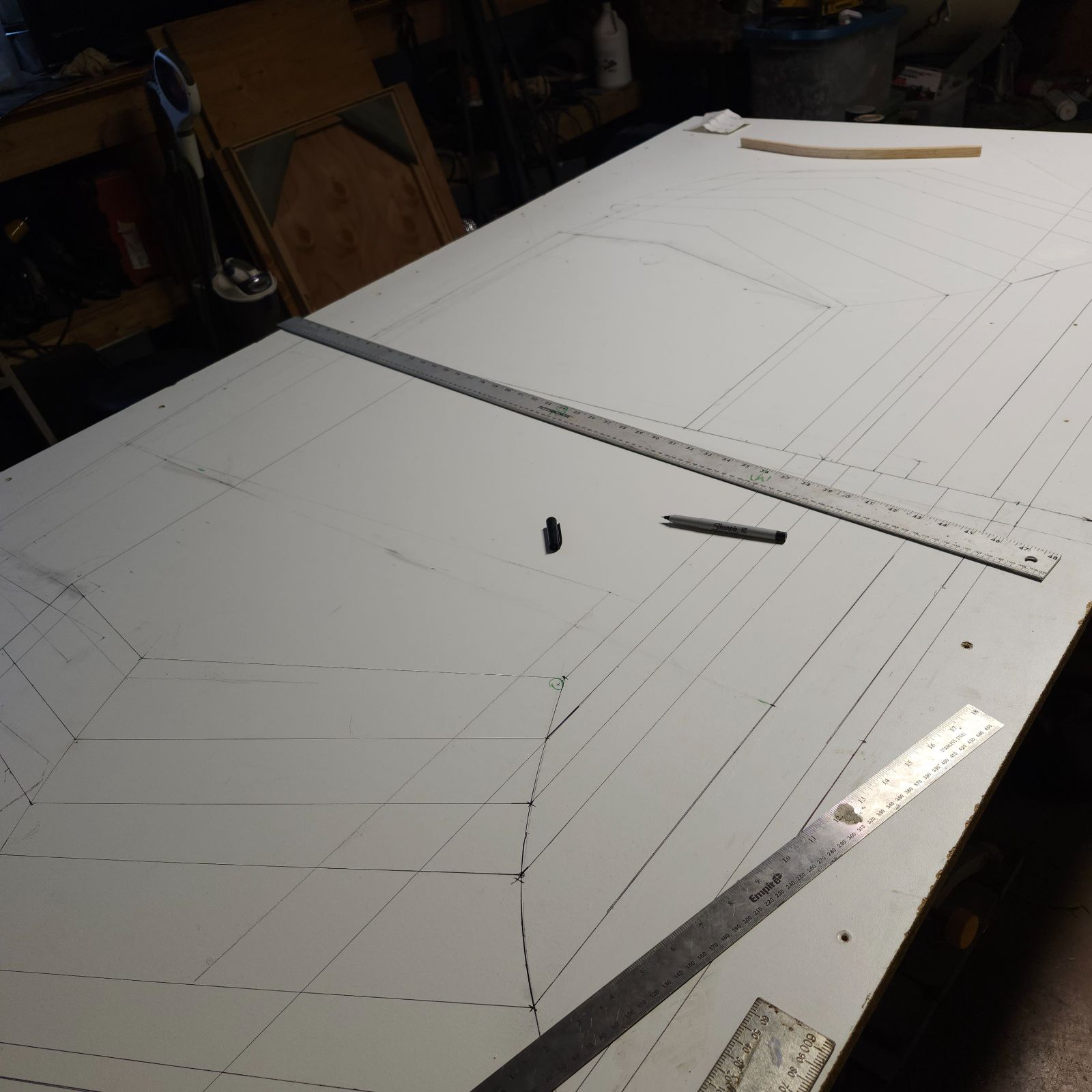

Lofting
December 14, 2025

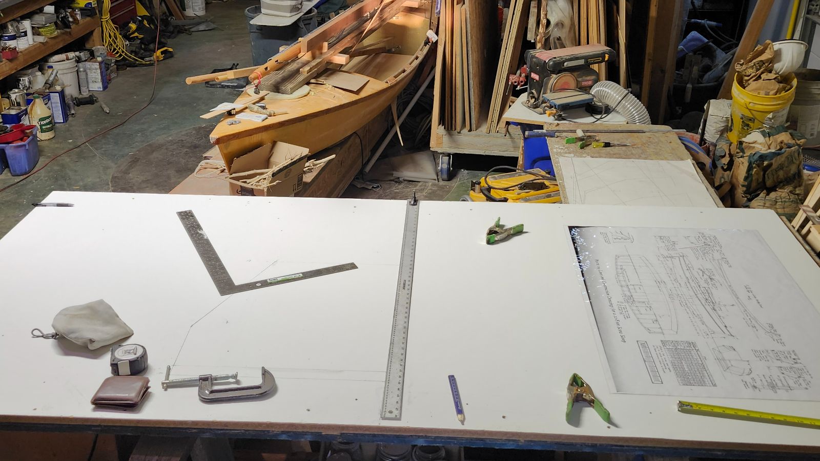

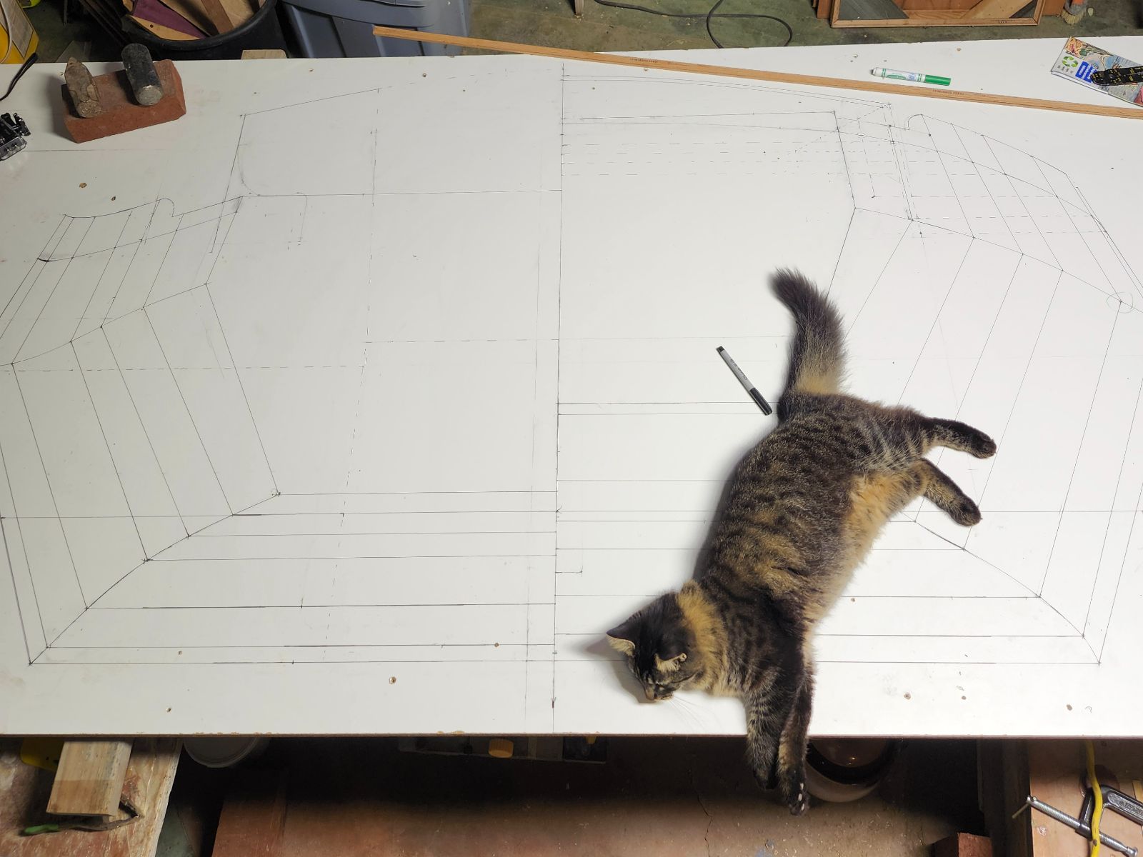

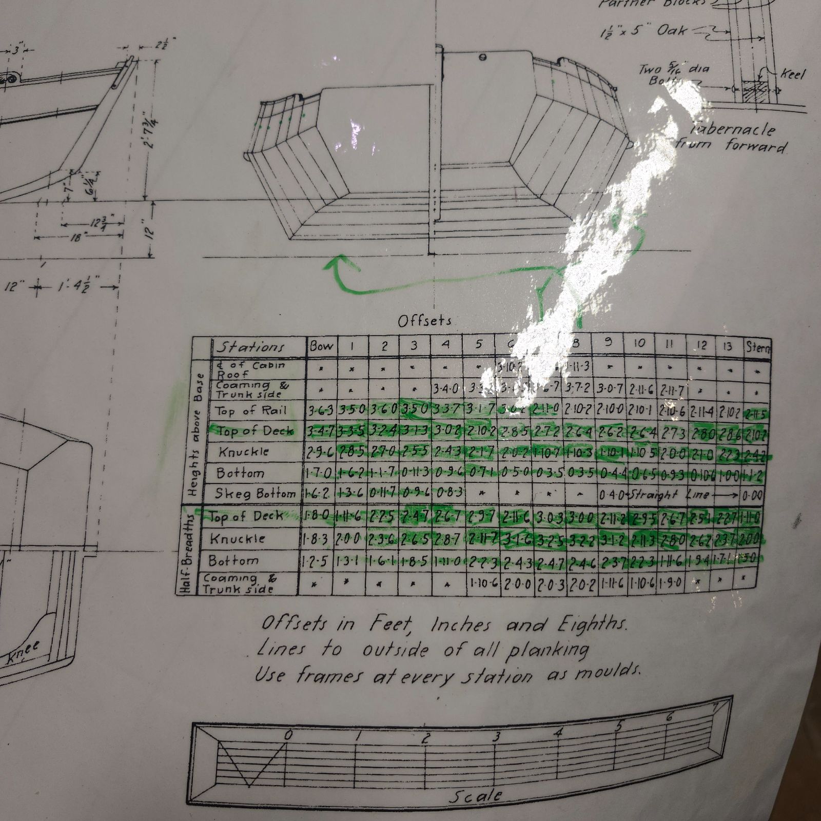

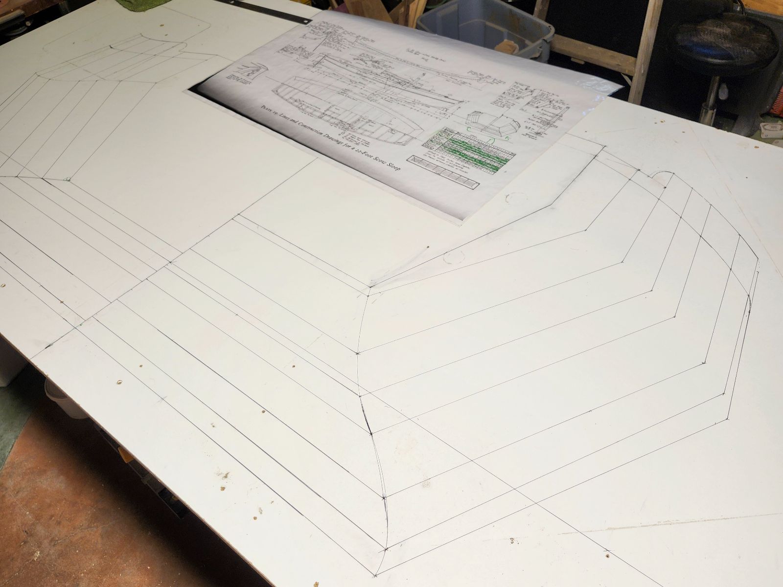

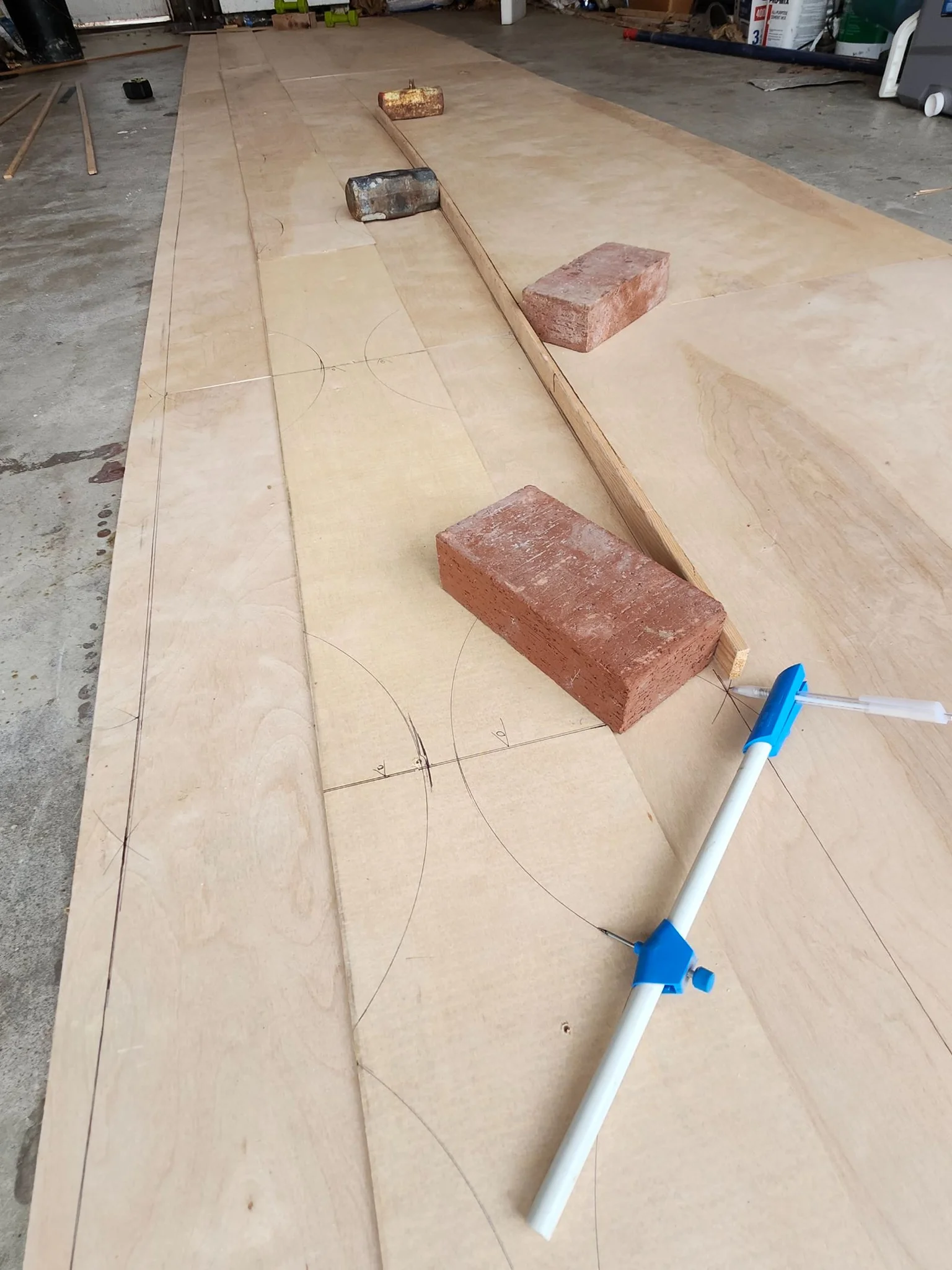

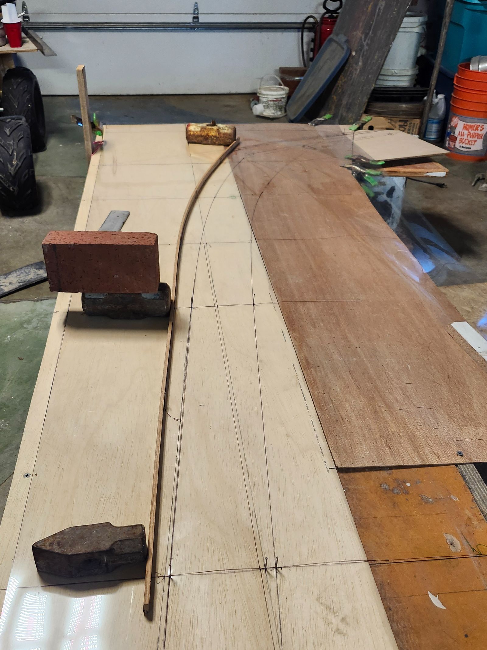

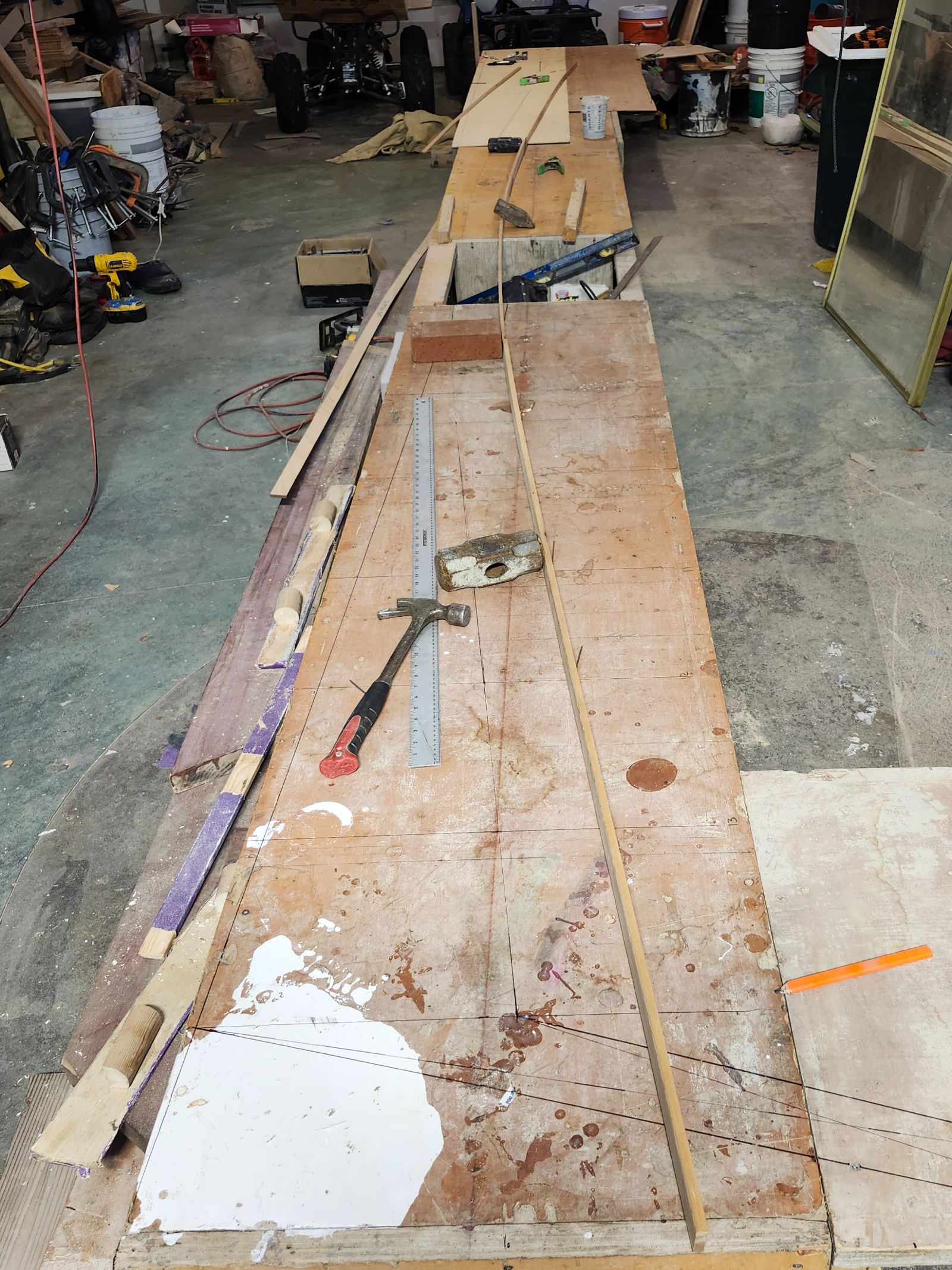

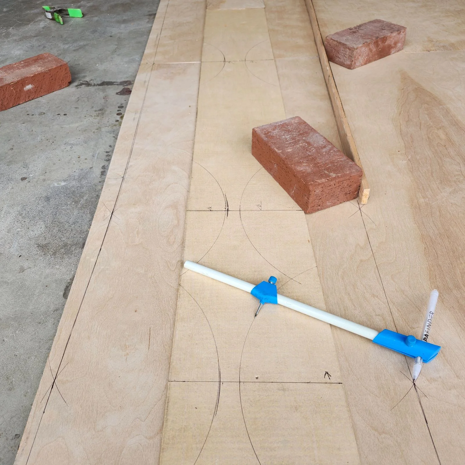

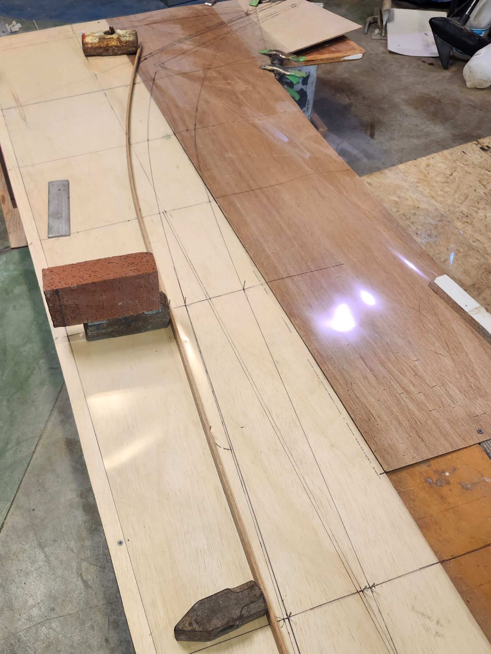

I took the book to a print shop. They blew up the pages to make print legible and laminated a big copy.
Washable markers were nice for keeping spot on table of offsets, or making notes.

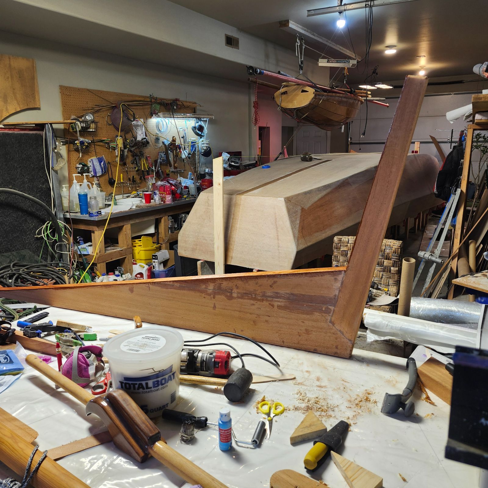

I tried to avoid lofting the entire keel, but quickly realized it was nessesary. My strong back providede a good space to draw it.
From there I was able make paterns for the front and back skeg. Don't forget to acount for the thickness of the planking!
I Spent alot of time lofting. I enjoyed it way more than I thougt I would. Helped me understand the design and provides ability to make patterns for any thing.

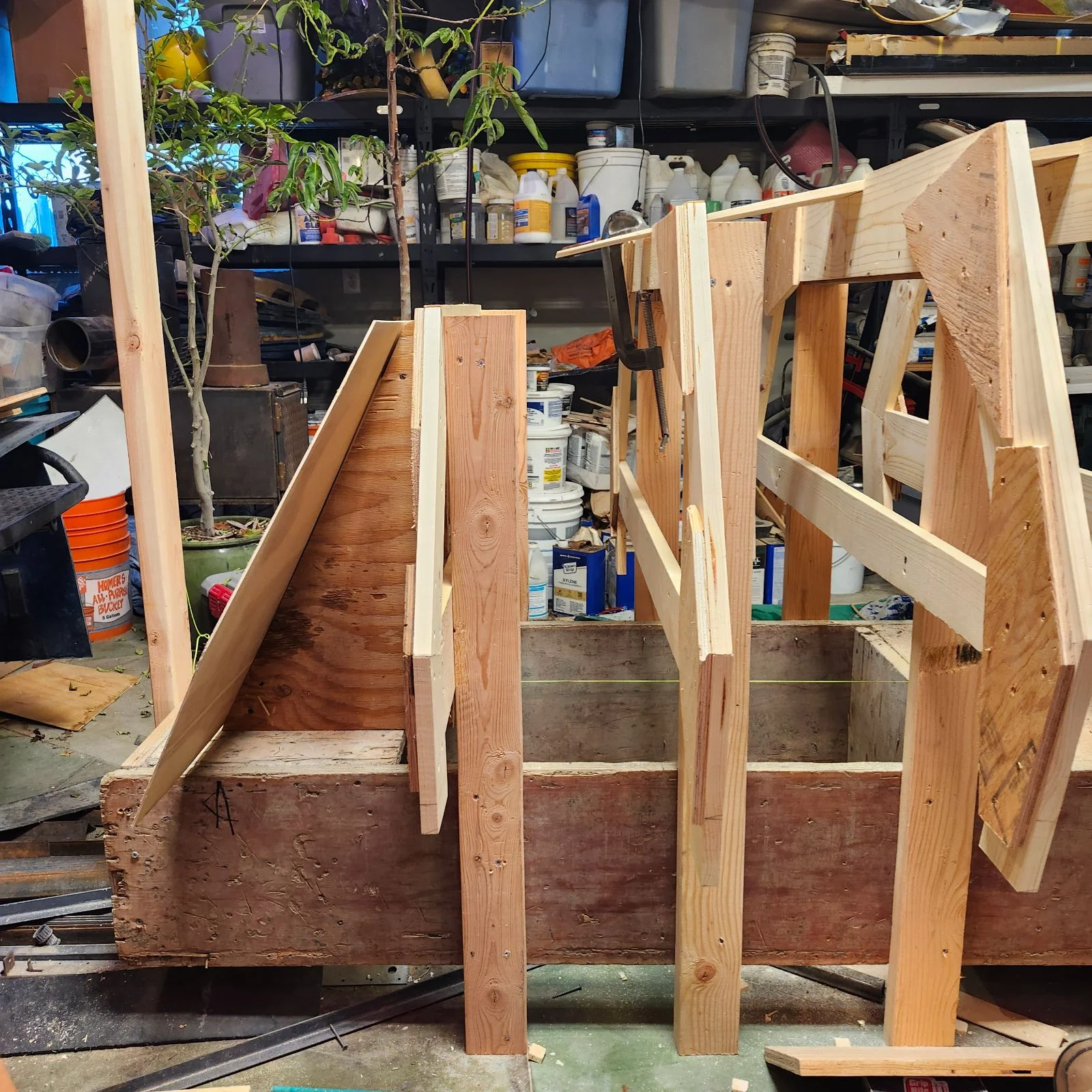

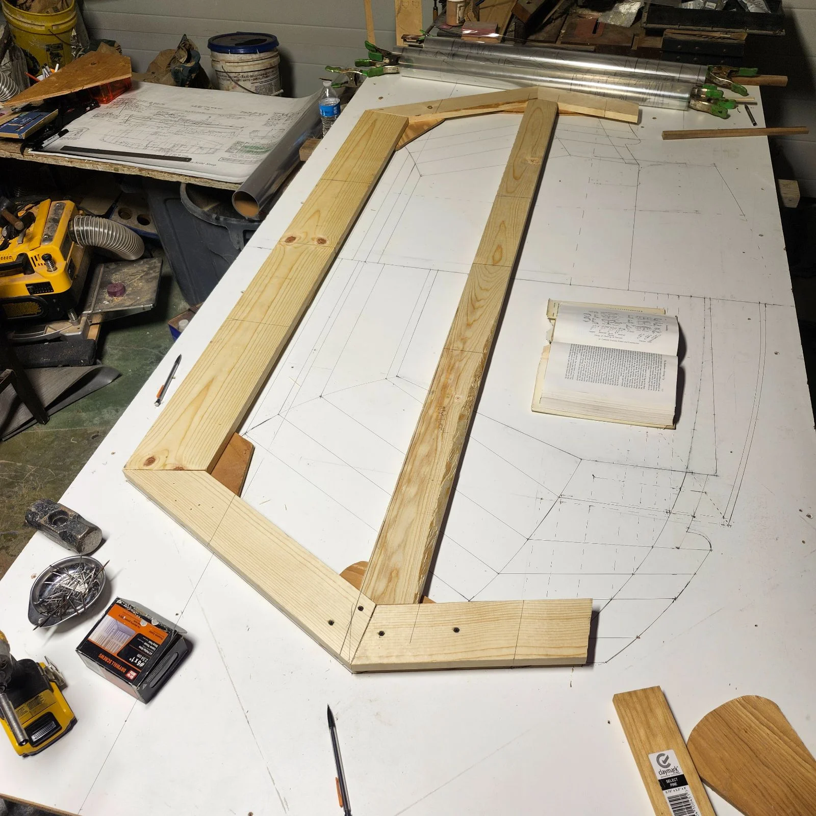

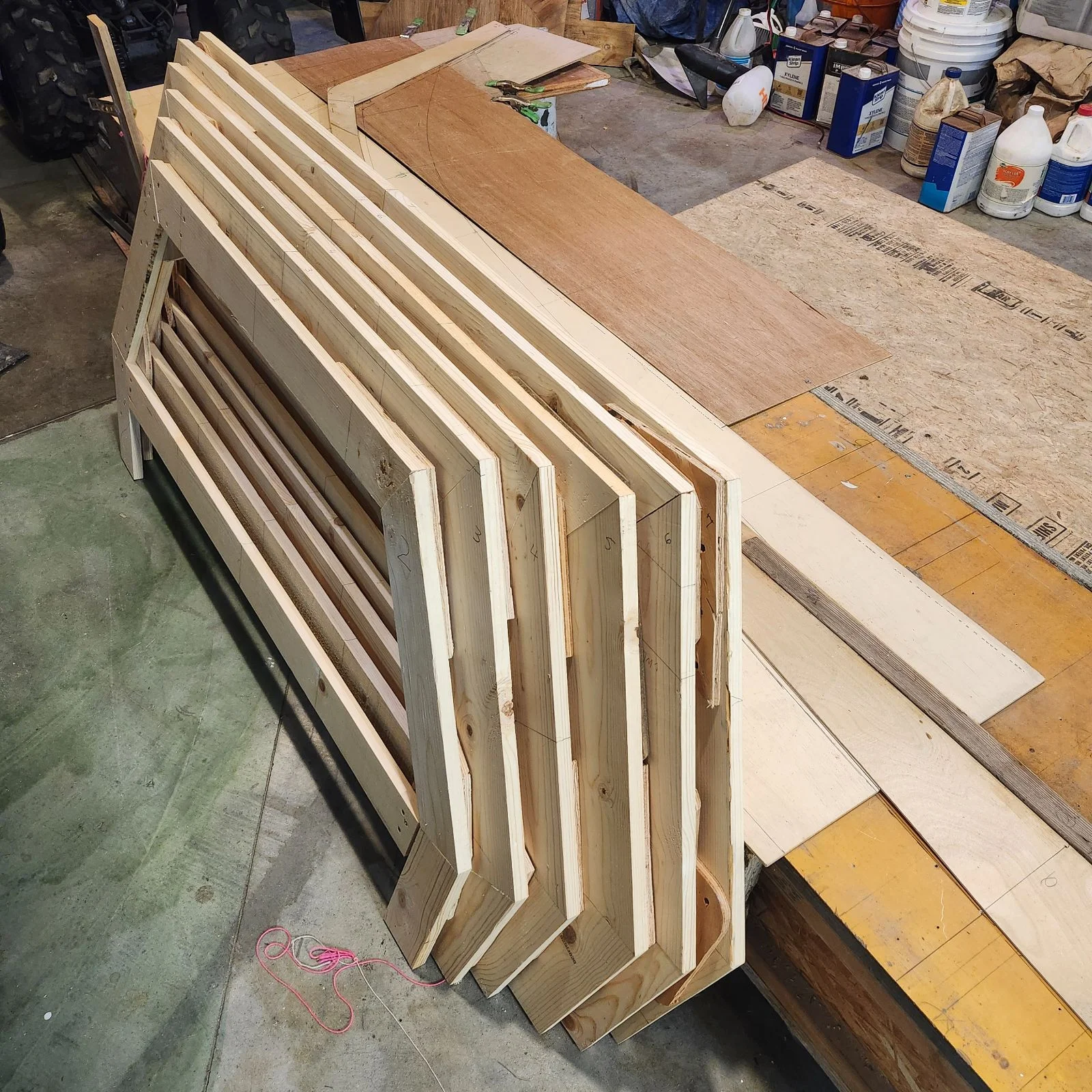

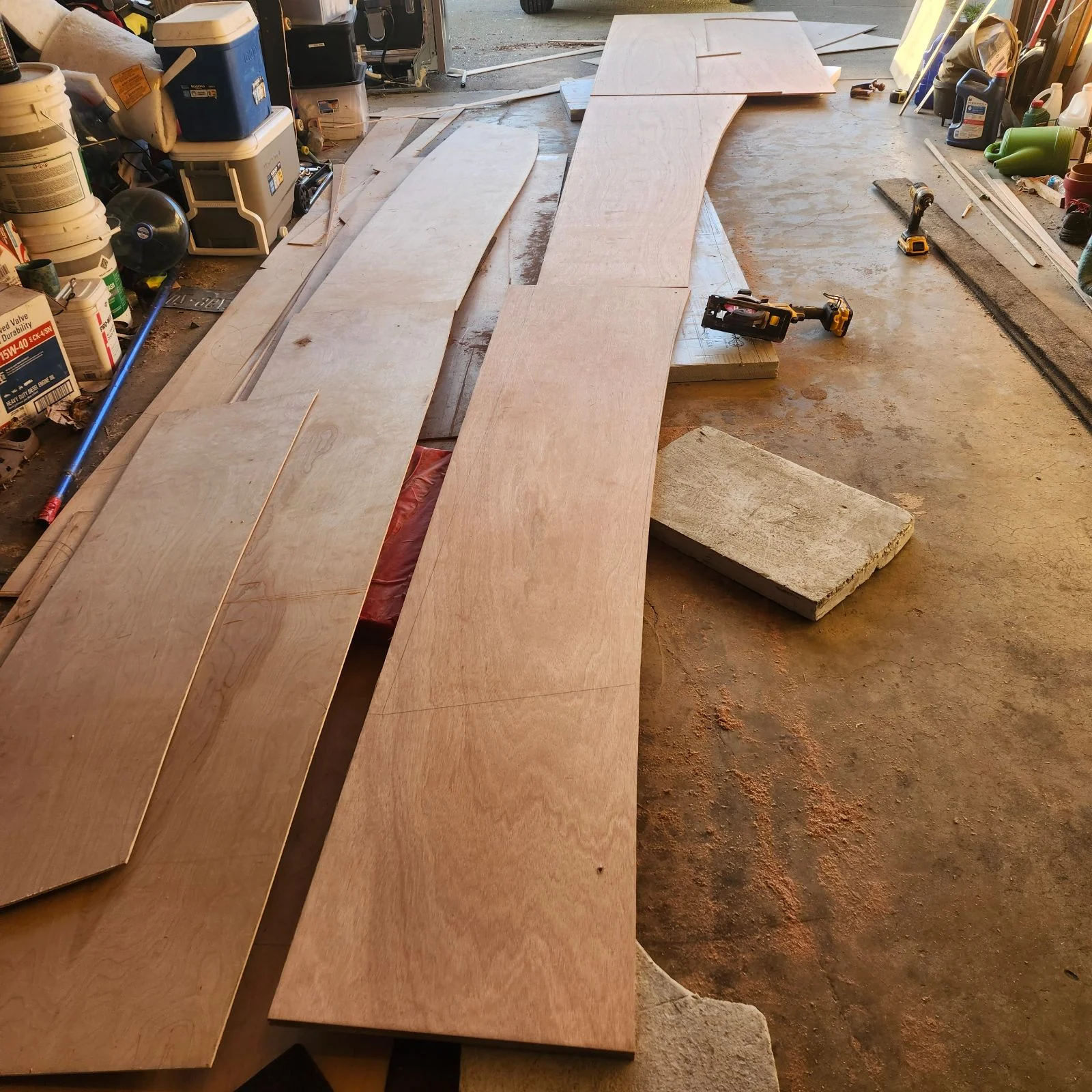

Forms & pattens
December 26, 2025

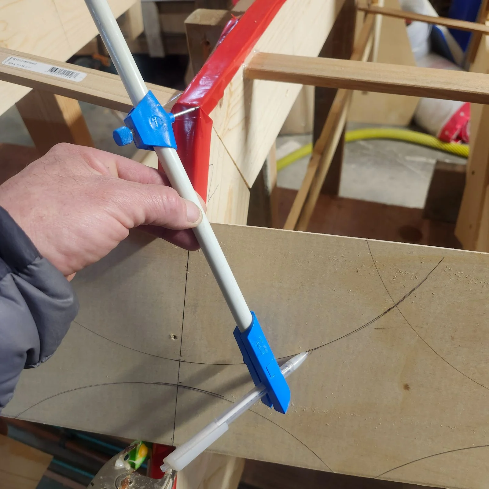

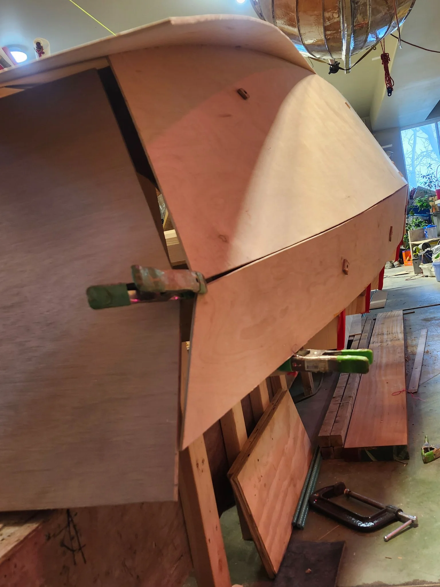

Spiling....and...

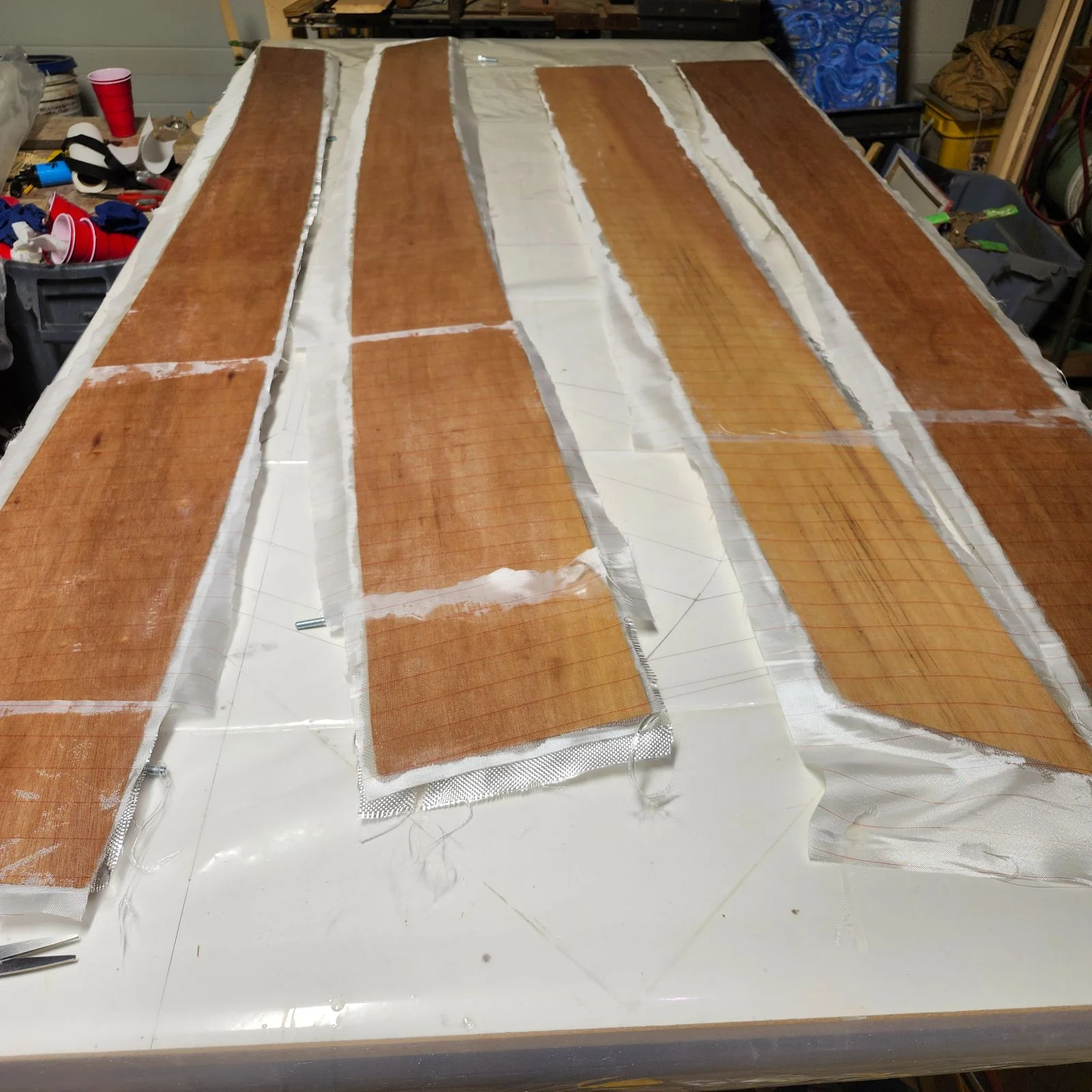

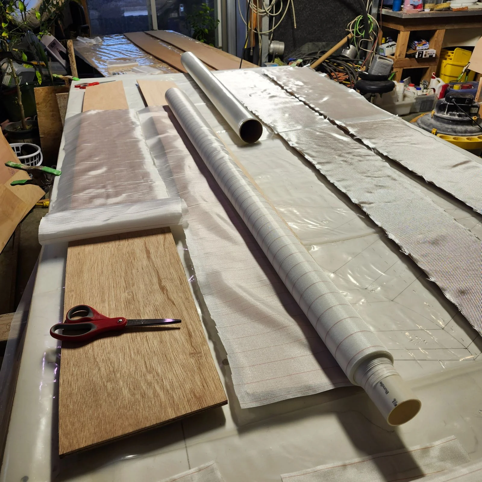

Glassing the inside sides.
January 19

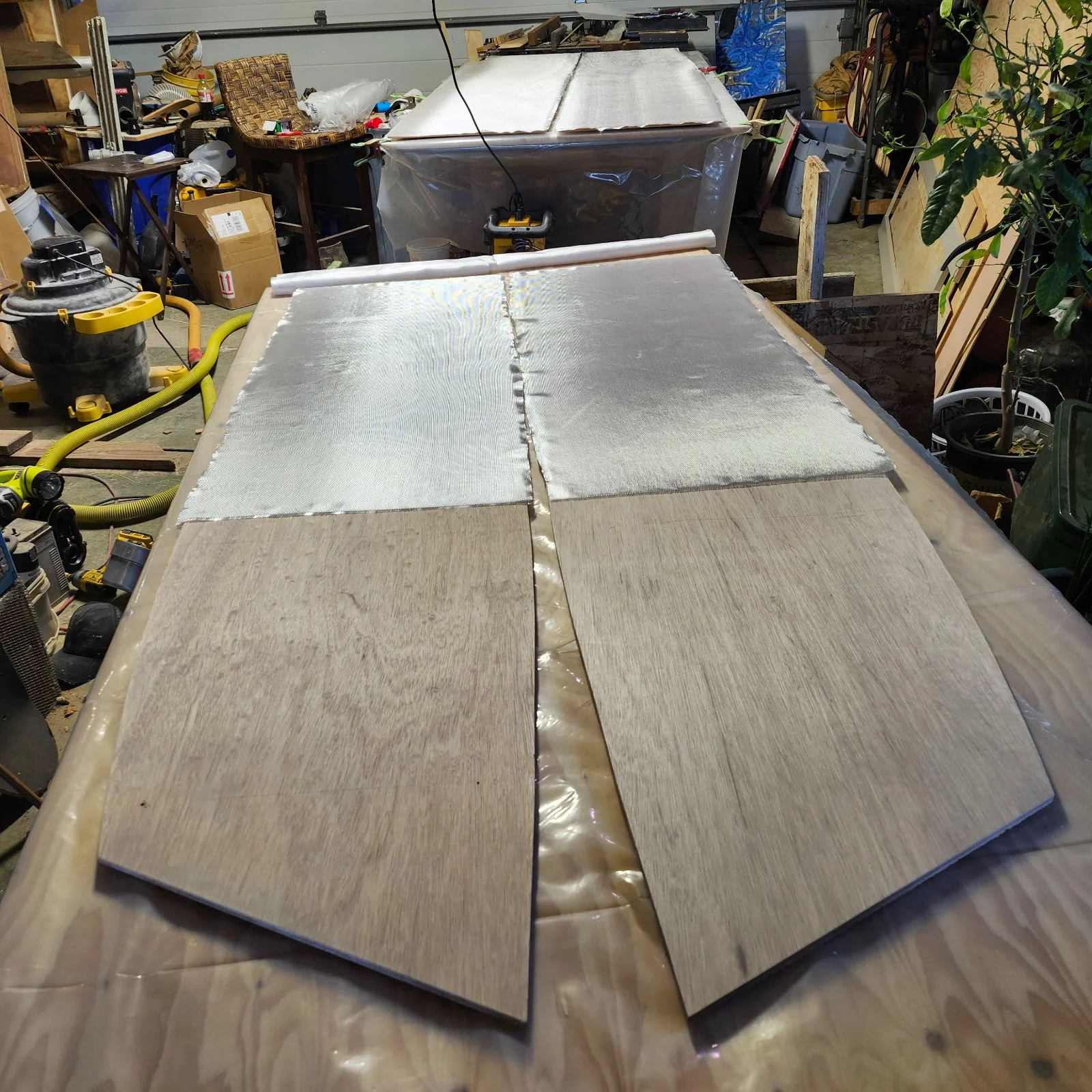

This time I'm pre glassing the inside sides.
Seams way easier on a flat bench.

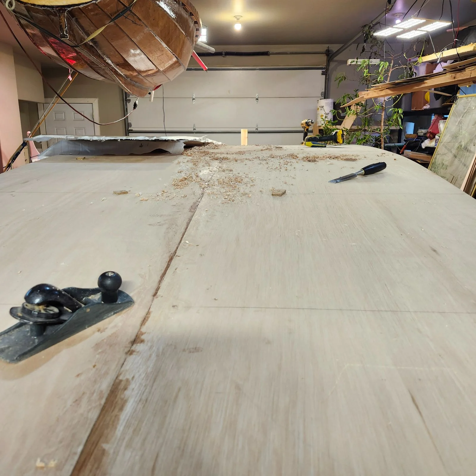

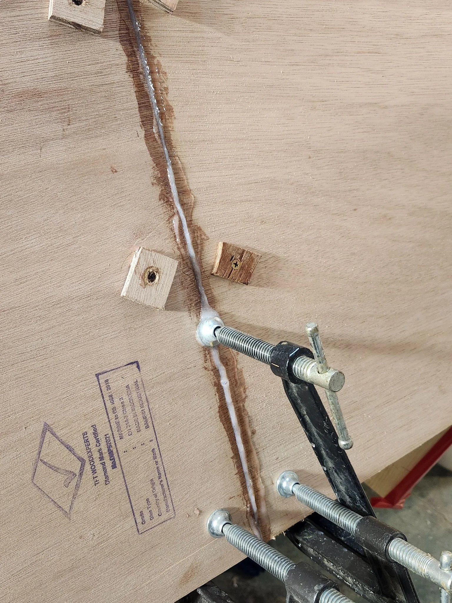

Butt blocks and edge glueing.
January 19

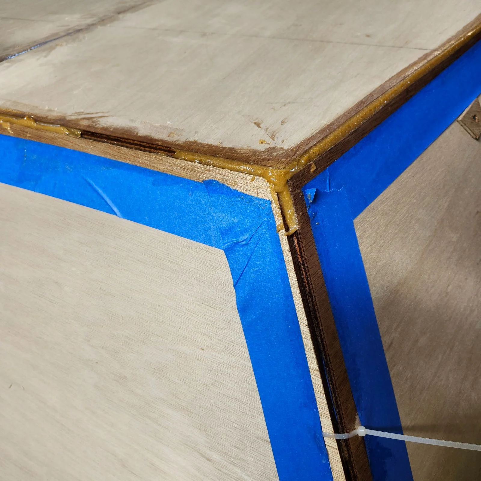

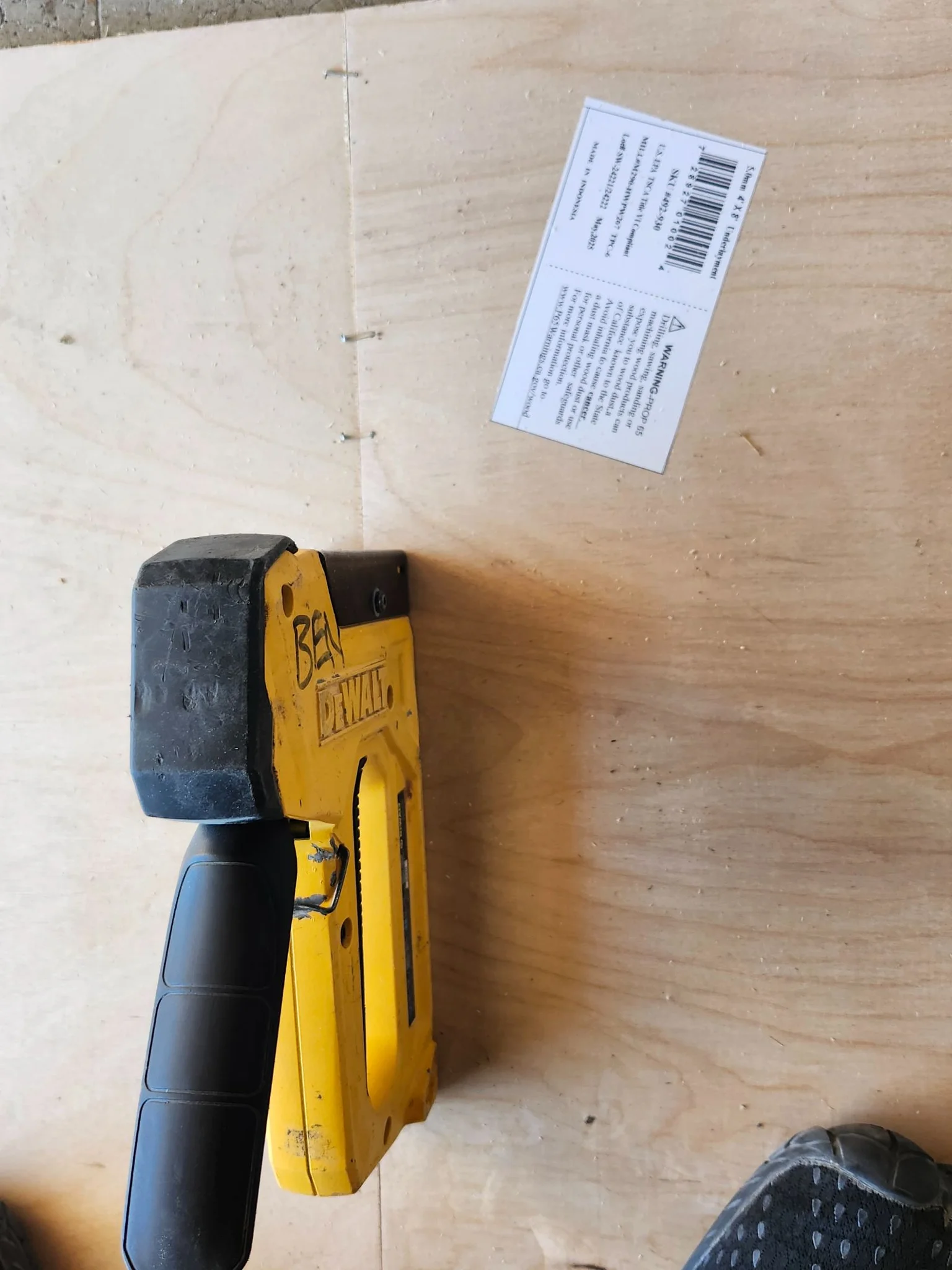

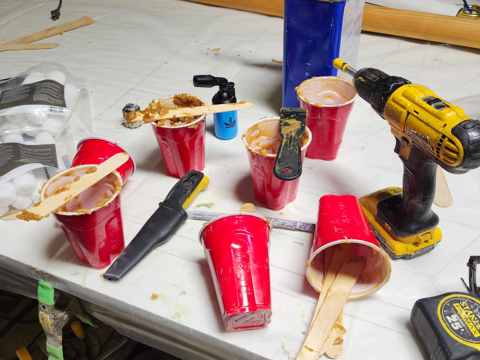

Joined all panels.
Pumped, mixed, planed sanded and shaped till my fingers and wrists swelled up.

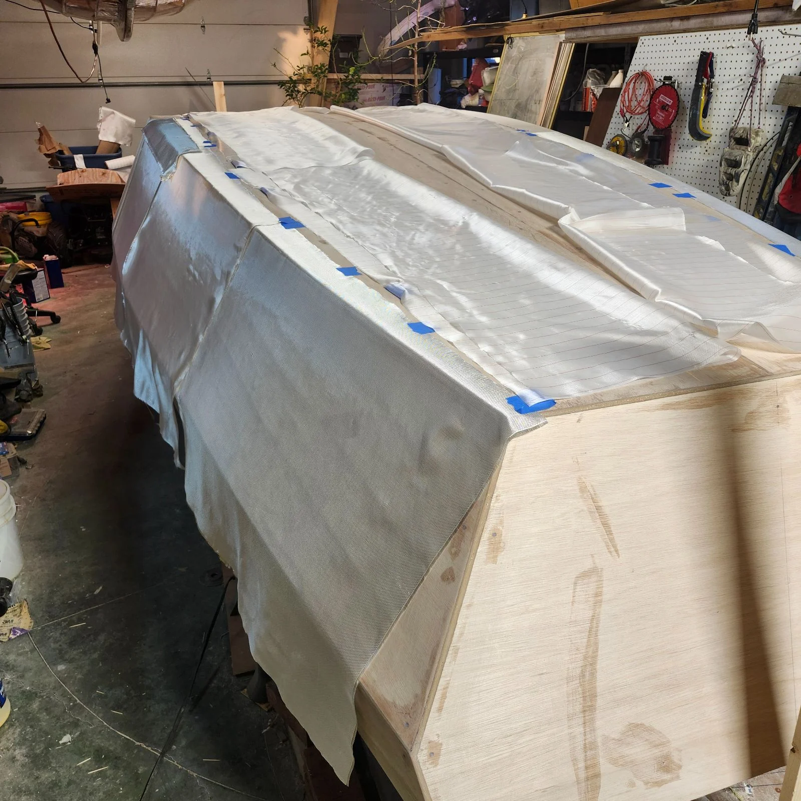

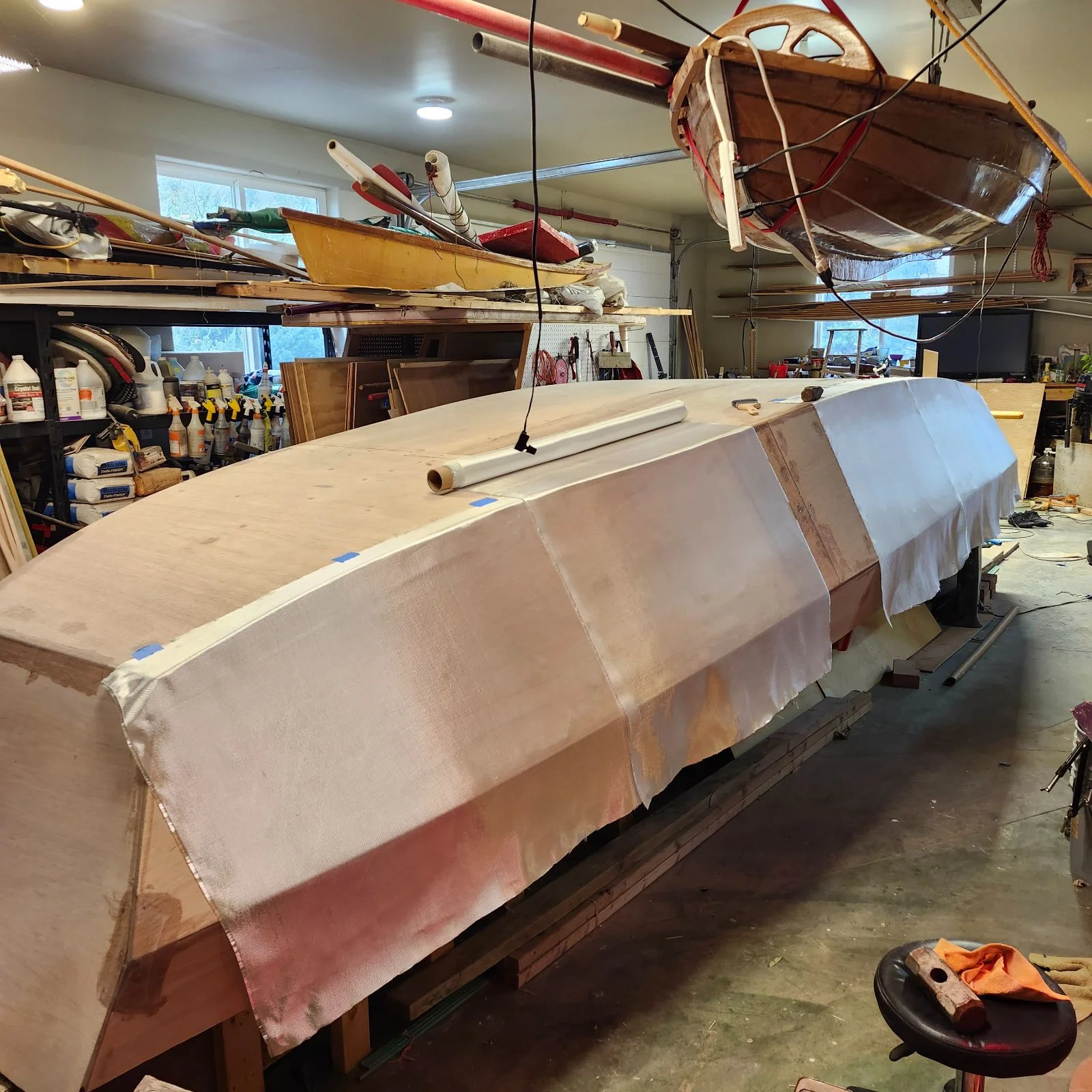

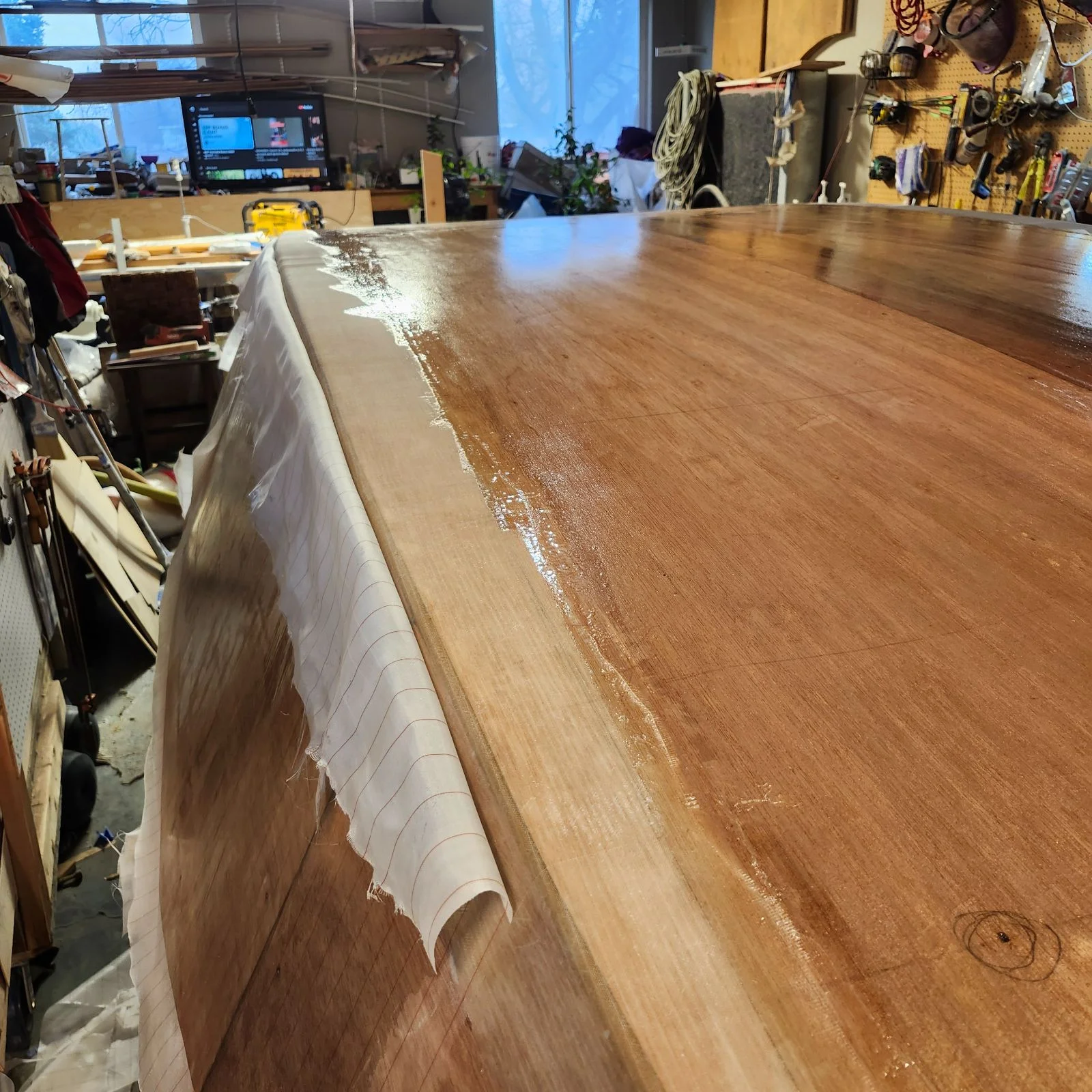

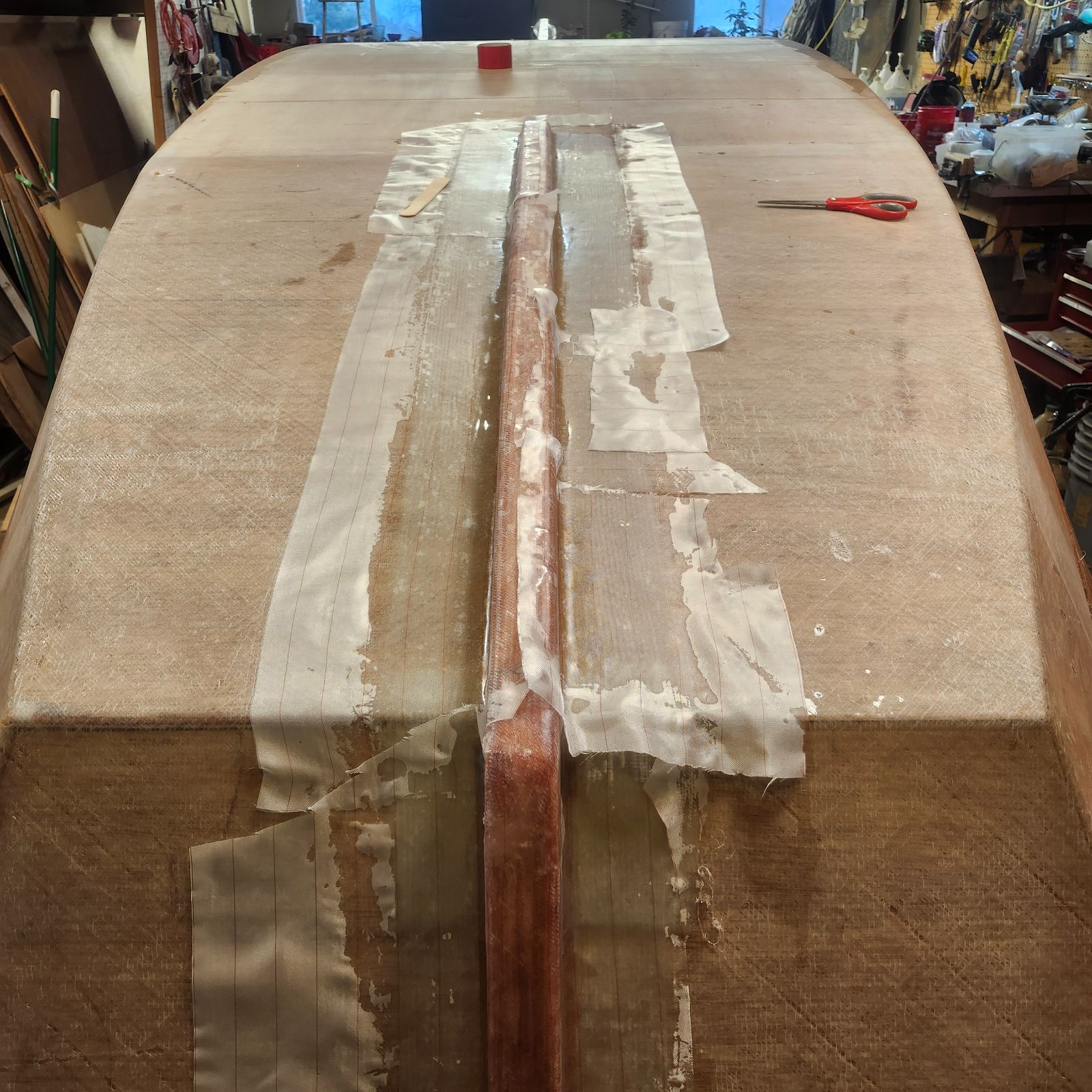

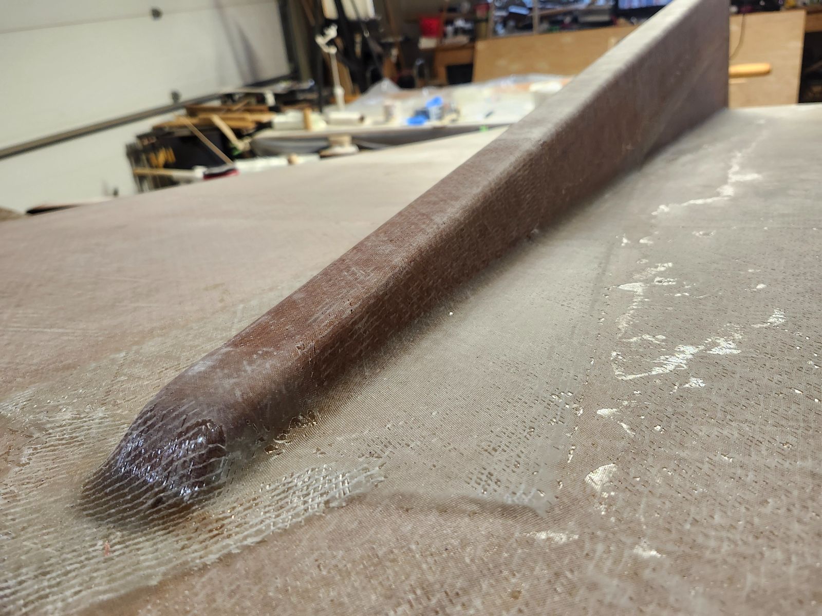

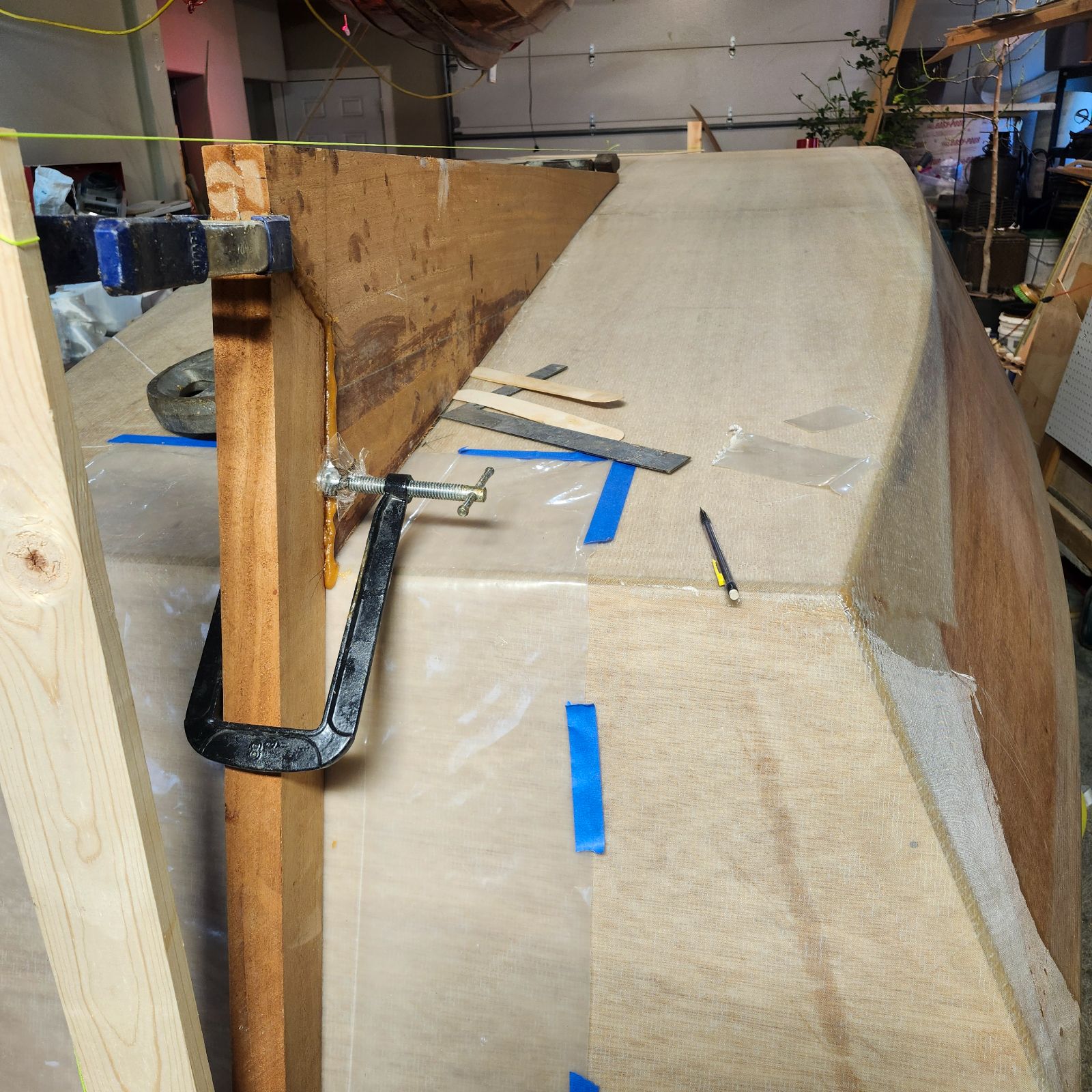

Fiberglass
March 29

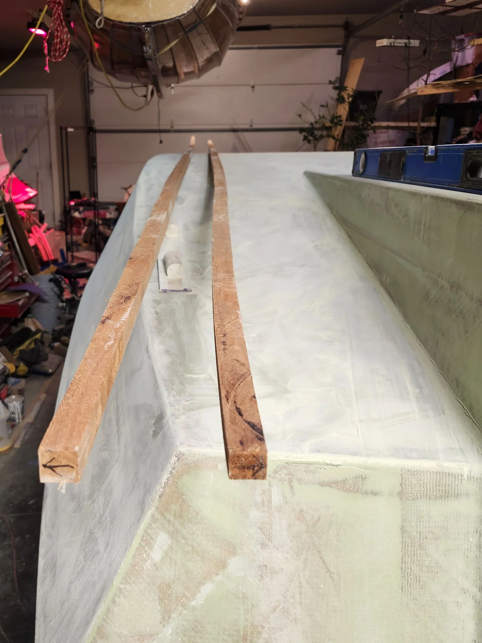

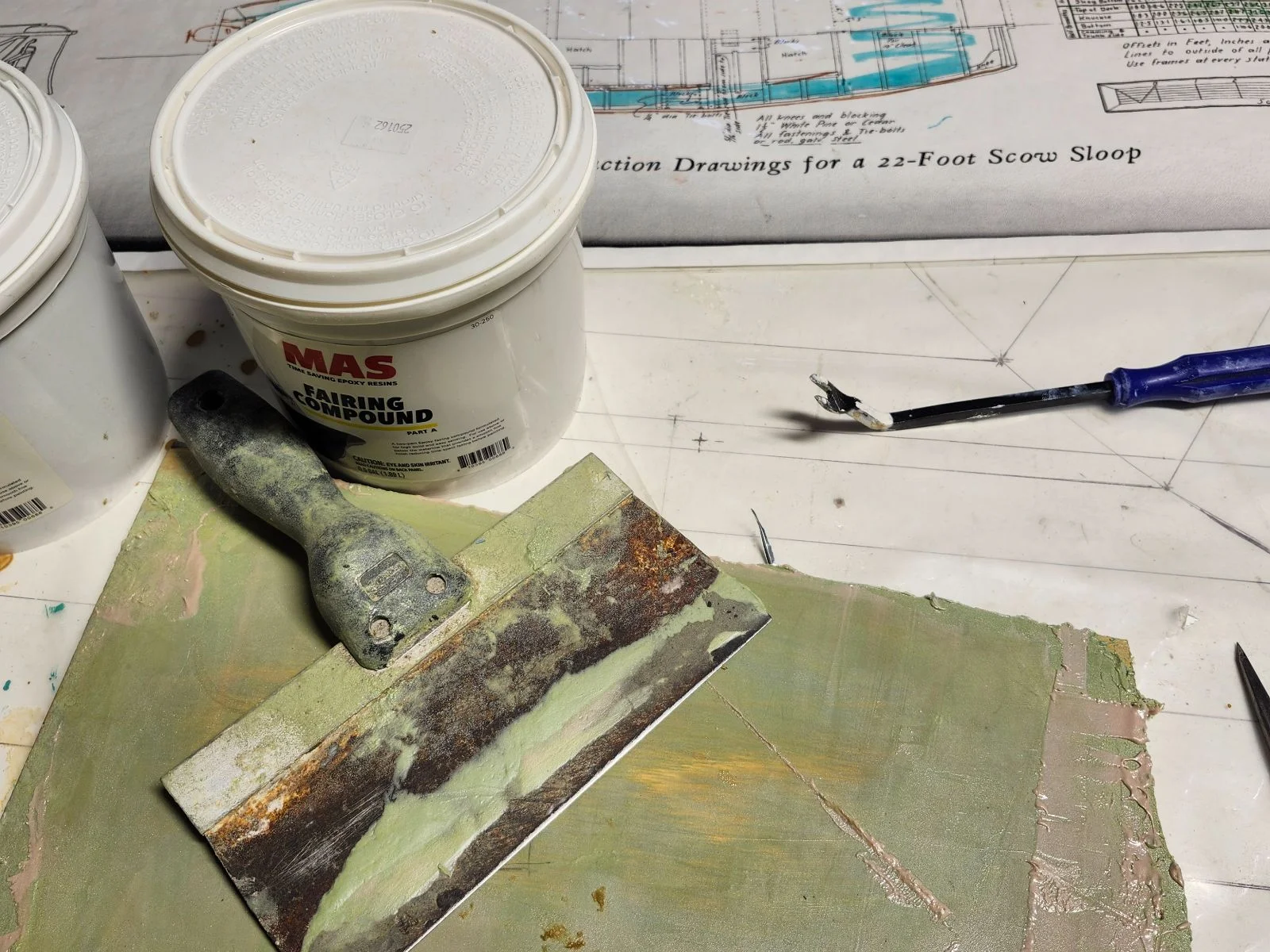

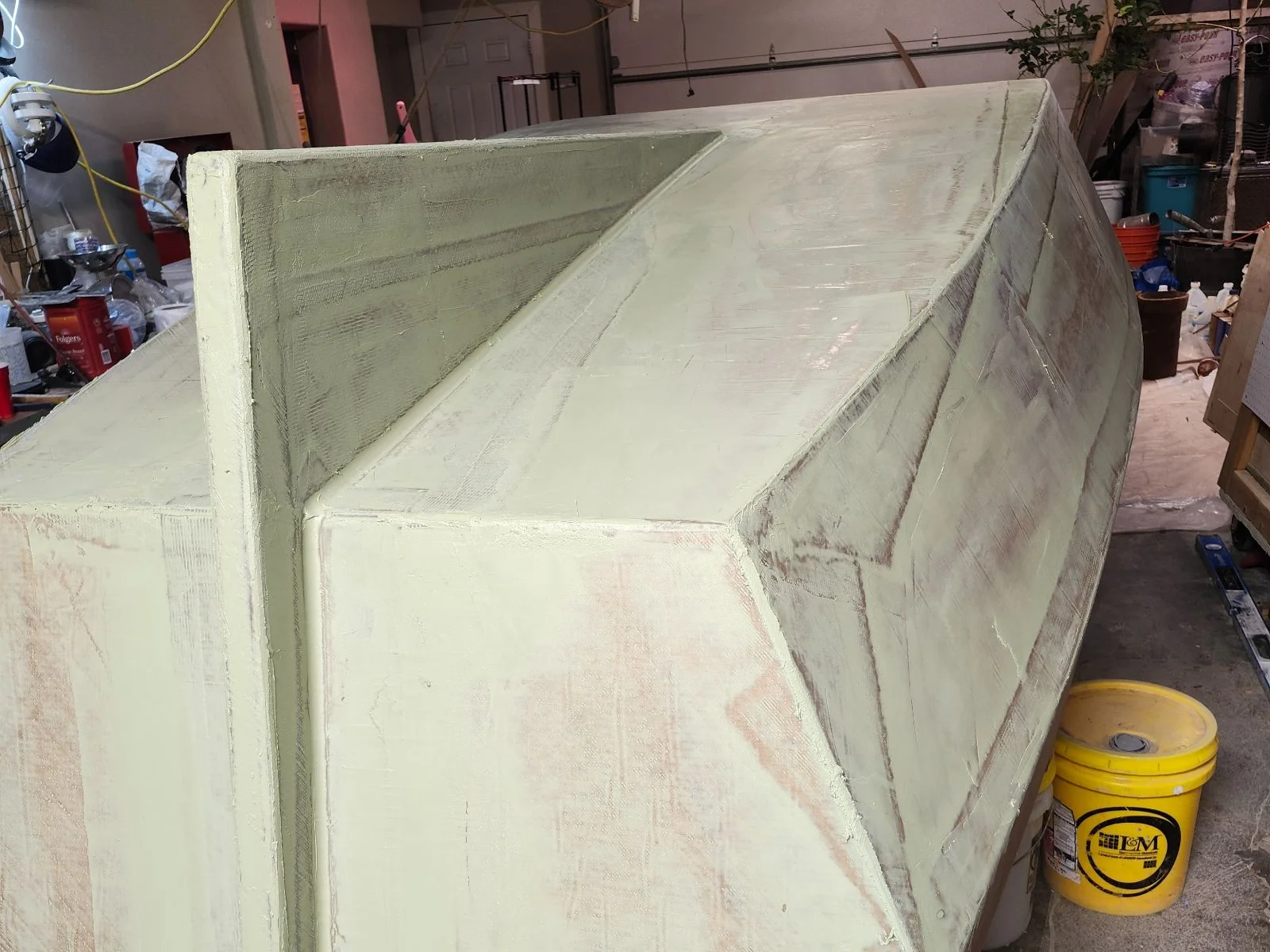

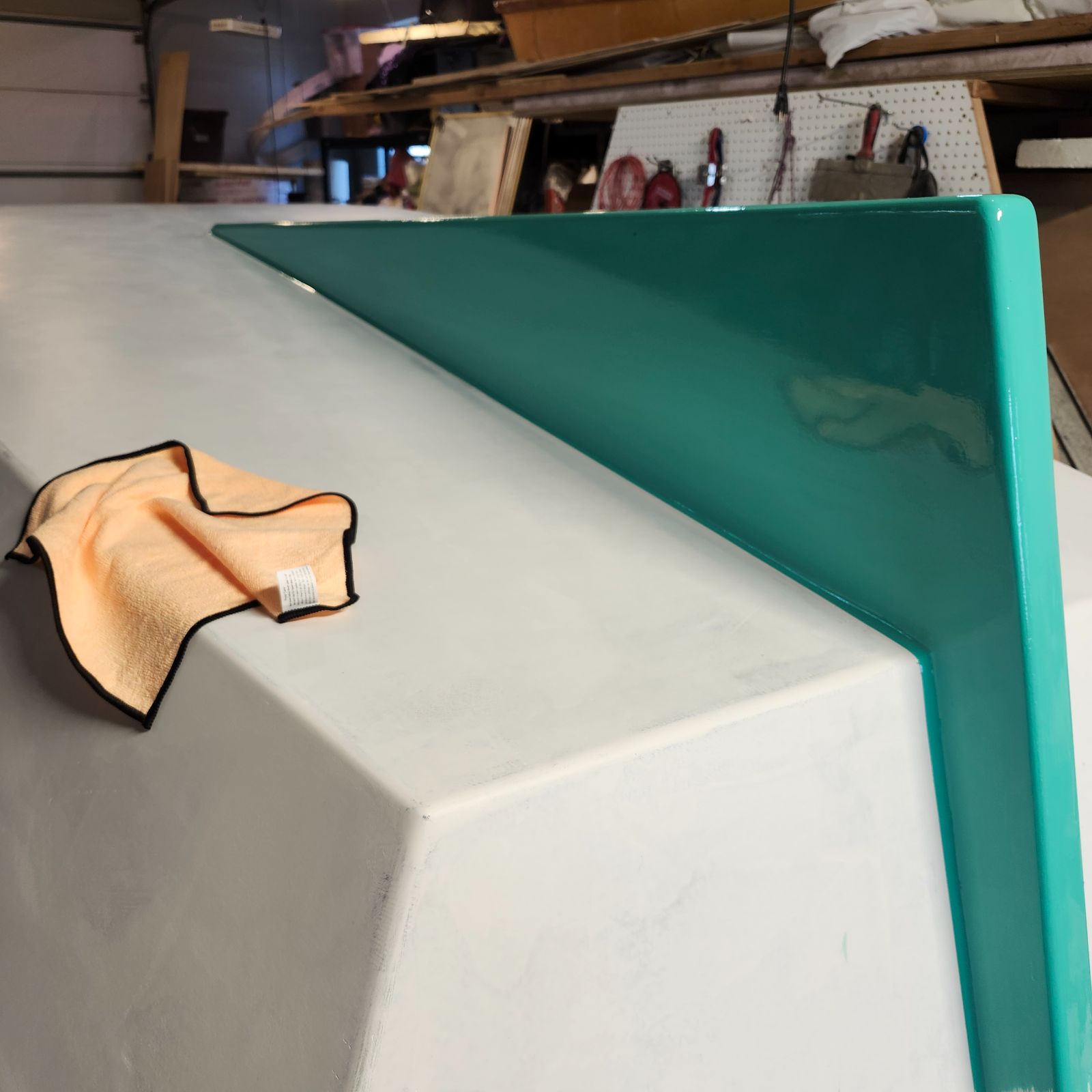

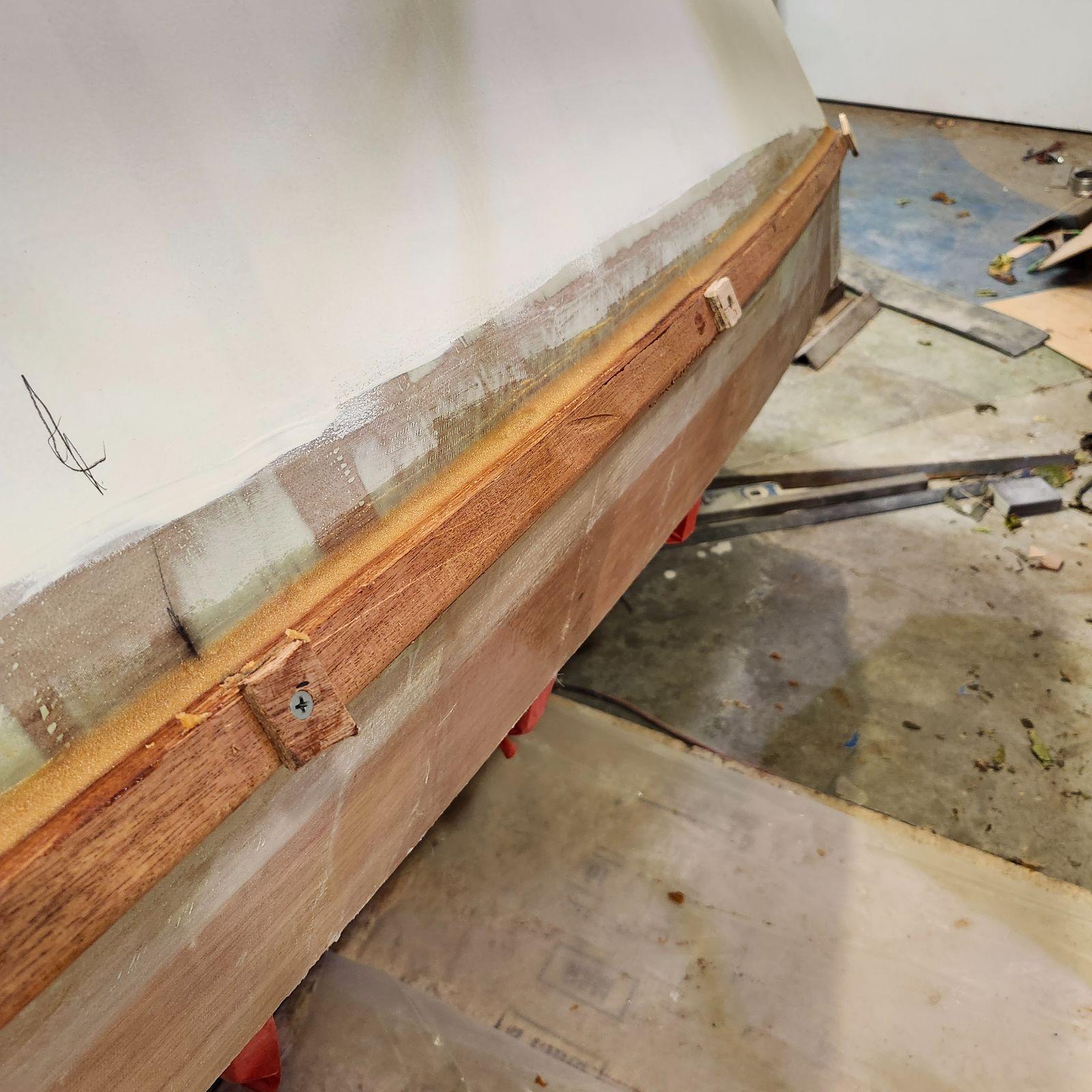

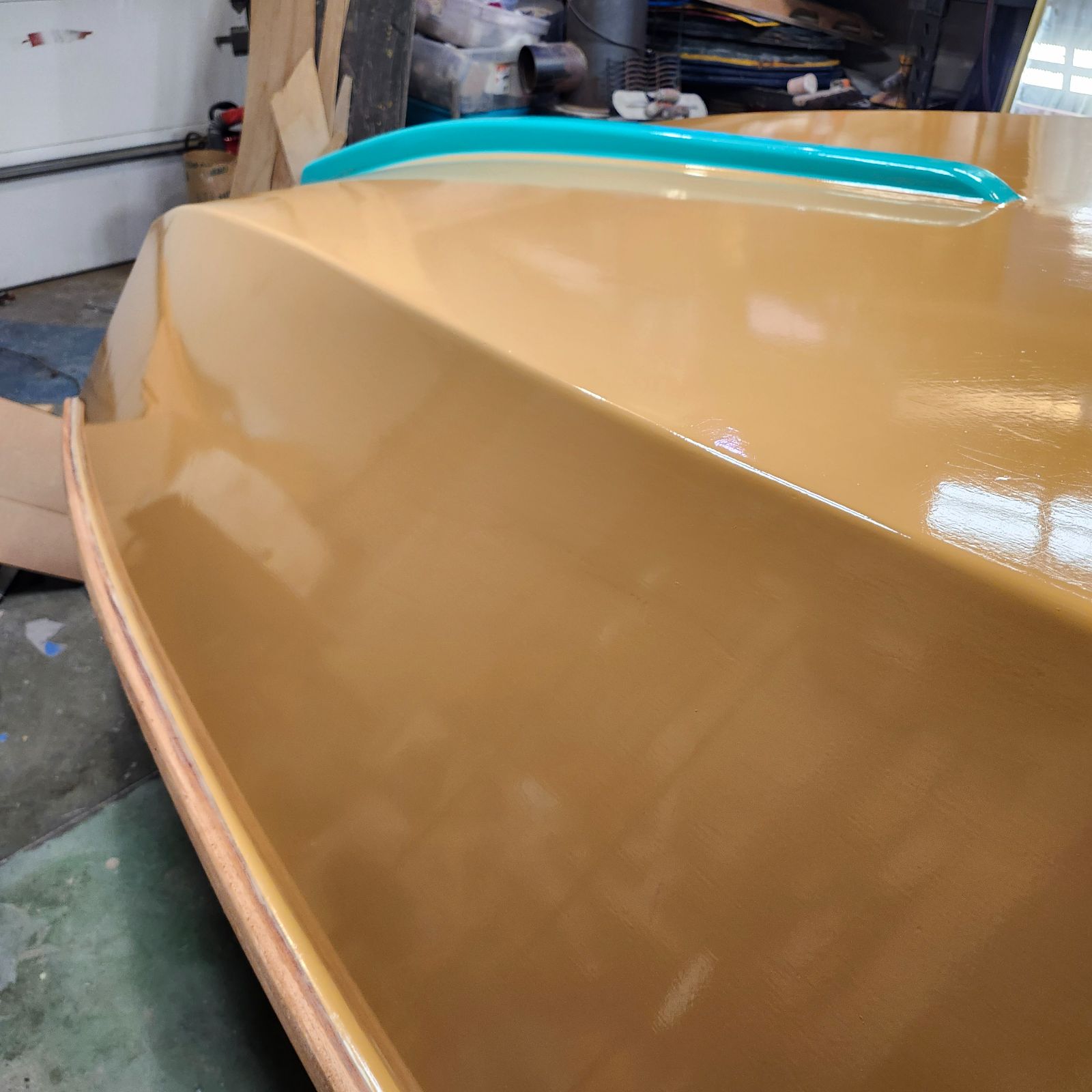

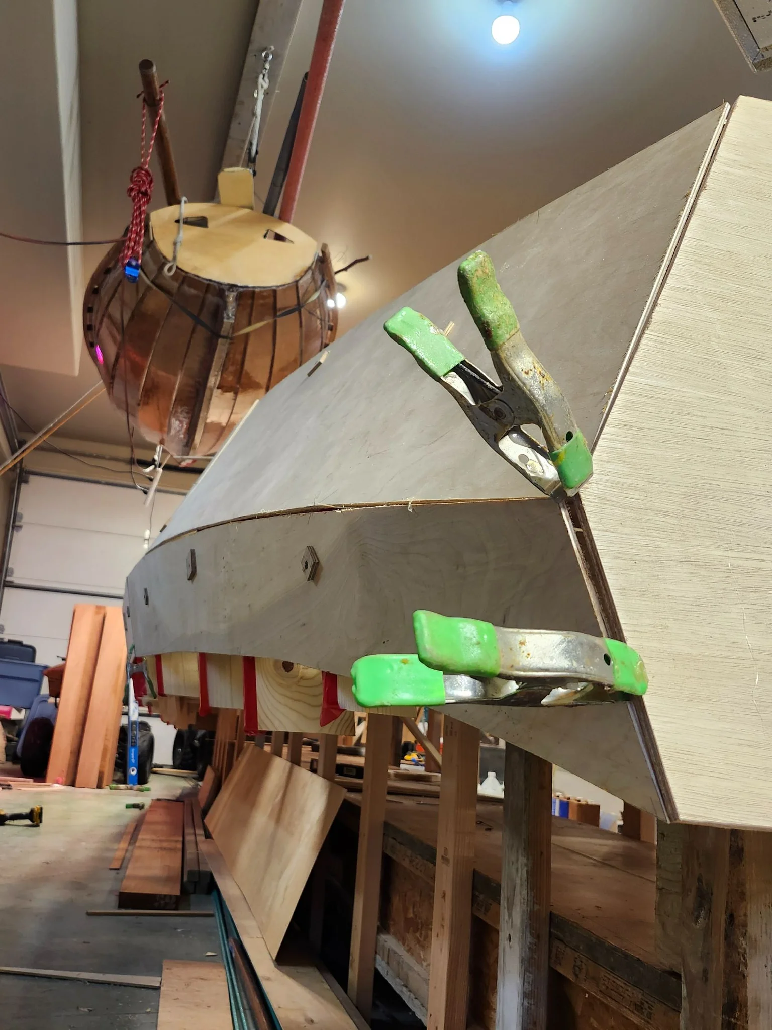

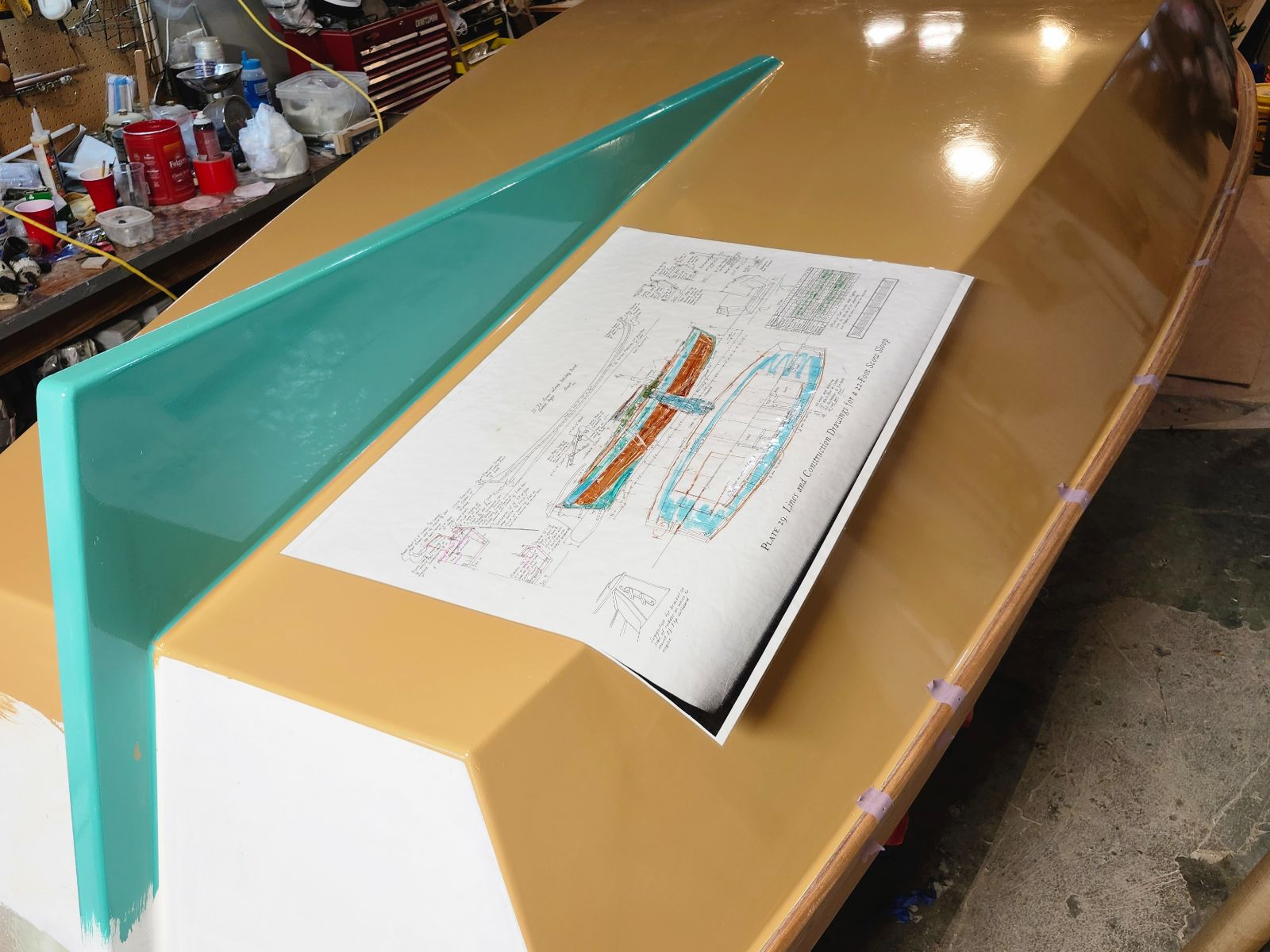

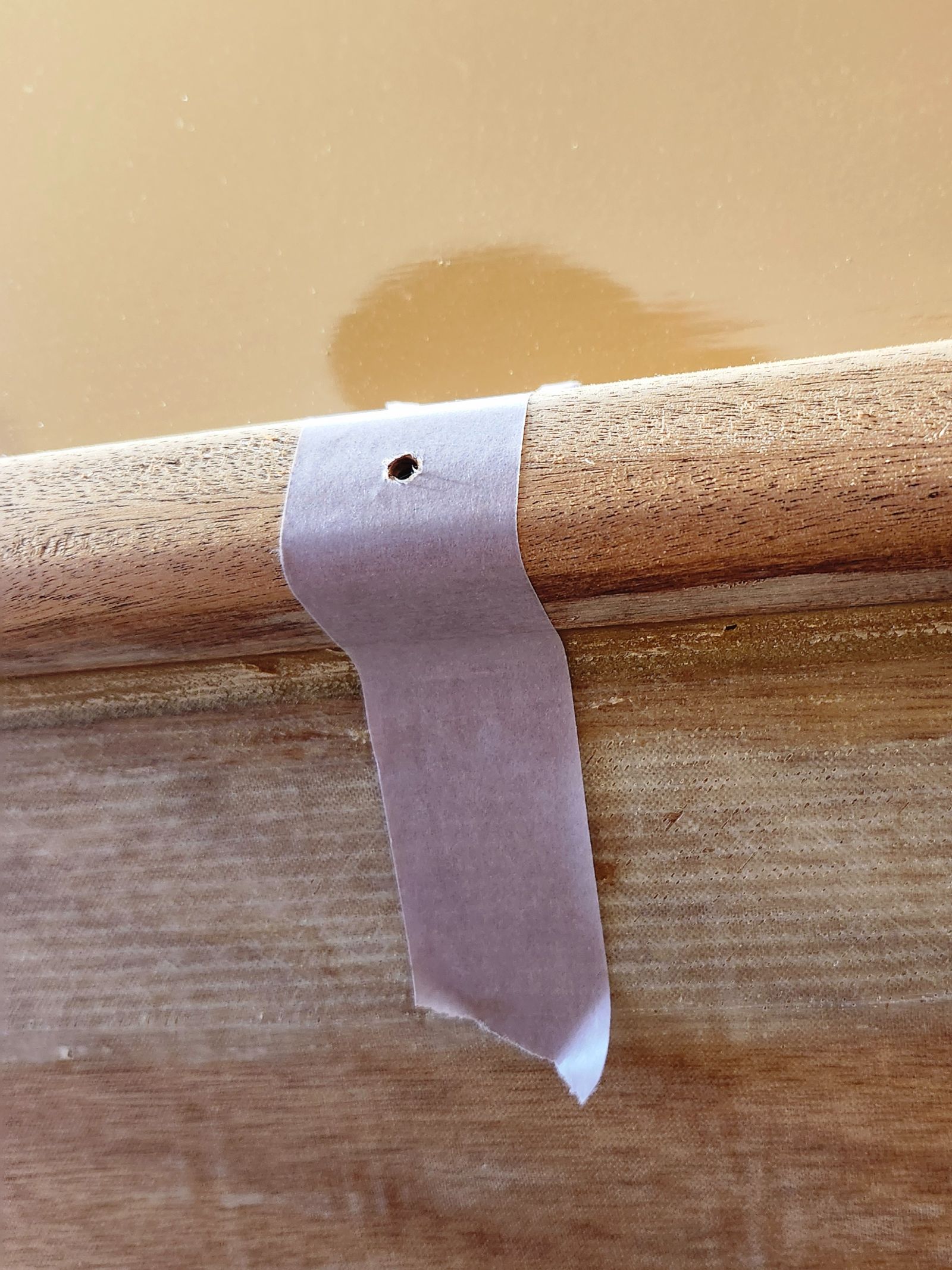

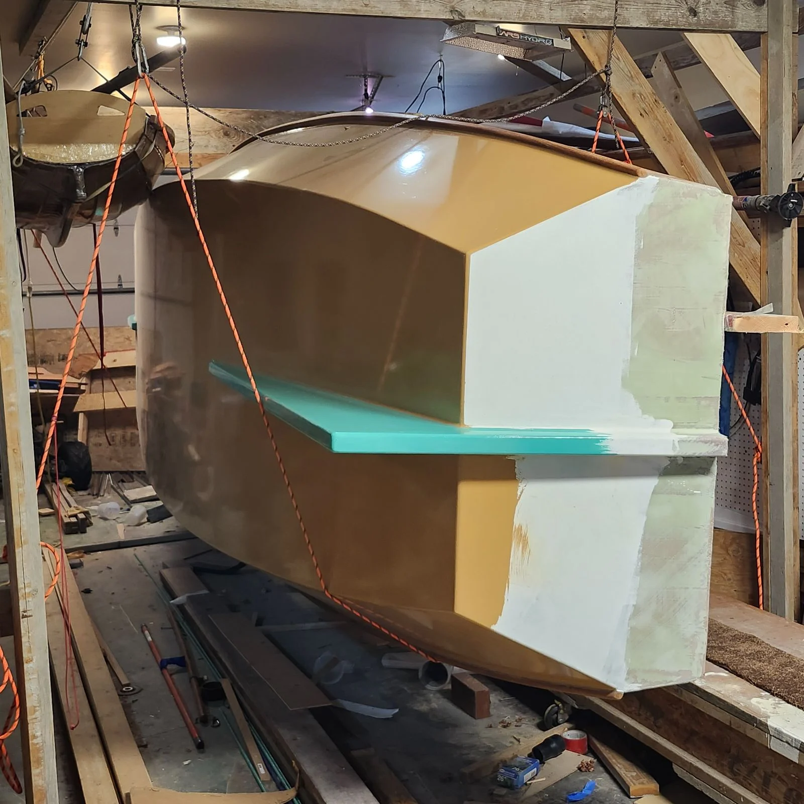

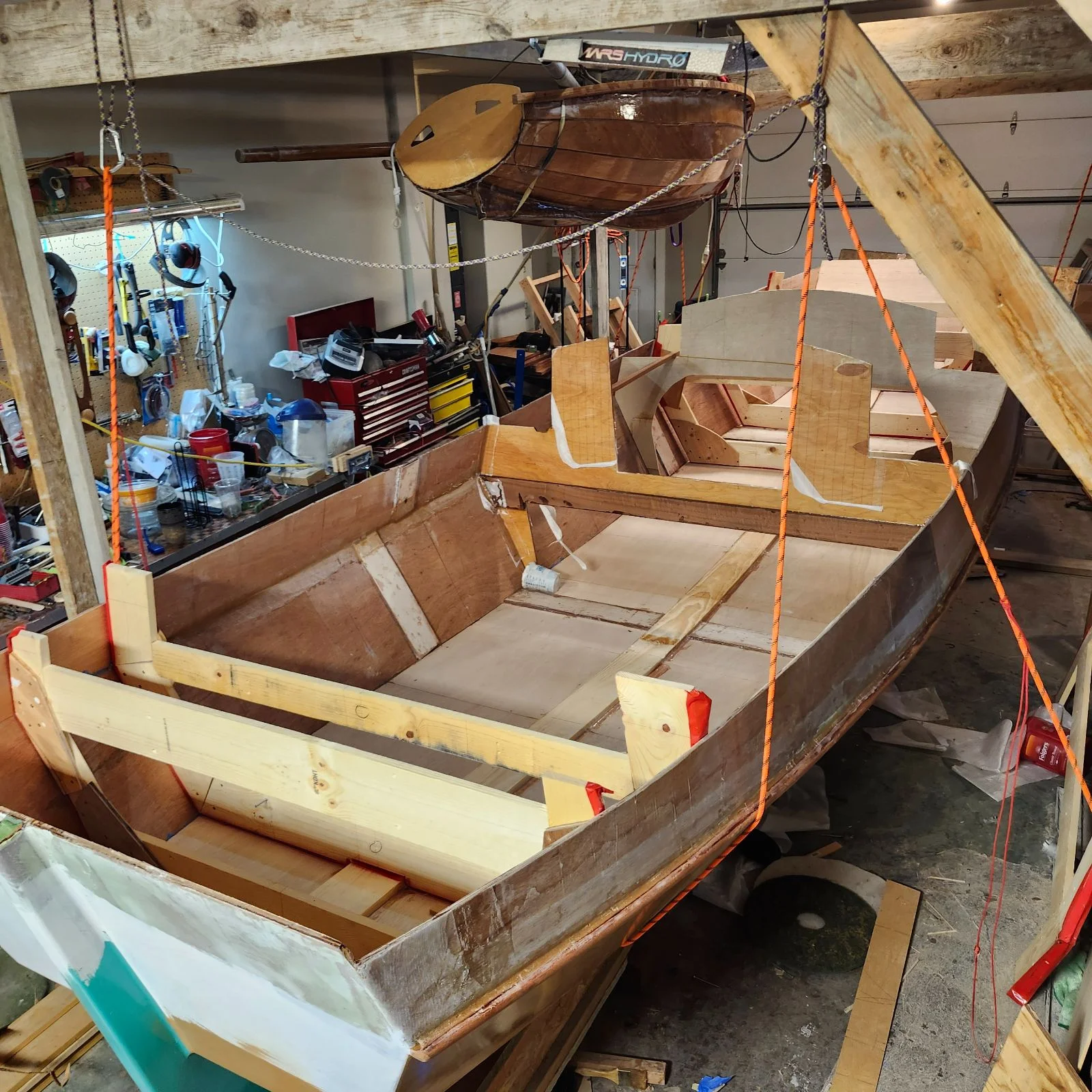

Fairing, rub rails, and paint.
April 3
